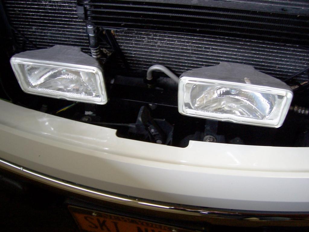

Well guys, part of growing up is learning when to admit defeat. And the Hella 75FF lights I used in this original installation just weren’t cutting it. Basically, I added them because the low beams were pretty decent on my truck, but the high beams were next to useless. (I’m running Phillips Extreme Vision bulbs in the headlights.)
So this past weekend I got a bug up my butt after looking at some LED units that would literally bolt right in – and probably put out more light. But when I got to looking at the cost, I went down in my basement to see what I might have laying around and could swap in for less.
What I found was another set of Hella 550s with 100 watt H3 bulbs. These were literally identical to what I used in my previous trucks and loved. Could I make these work instead? Well, after some careful measurement, I determined that although the outside perimeter of the lens would be shrouded by the grill, with a bit of modification to the bracket I built, these would center nicely in the same openings.
After several hours of disassembly, measurement, modification, trial and error fitting and re-fitting, here is what’s now behind the grill:

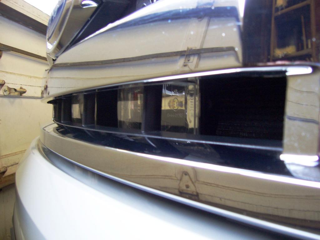

Here’s the shrouding effect. And in this picture, I still had the amber 100 watt bulbs I was using for a previous application. I now have regular (clear) 100 watt bulbs in them.

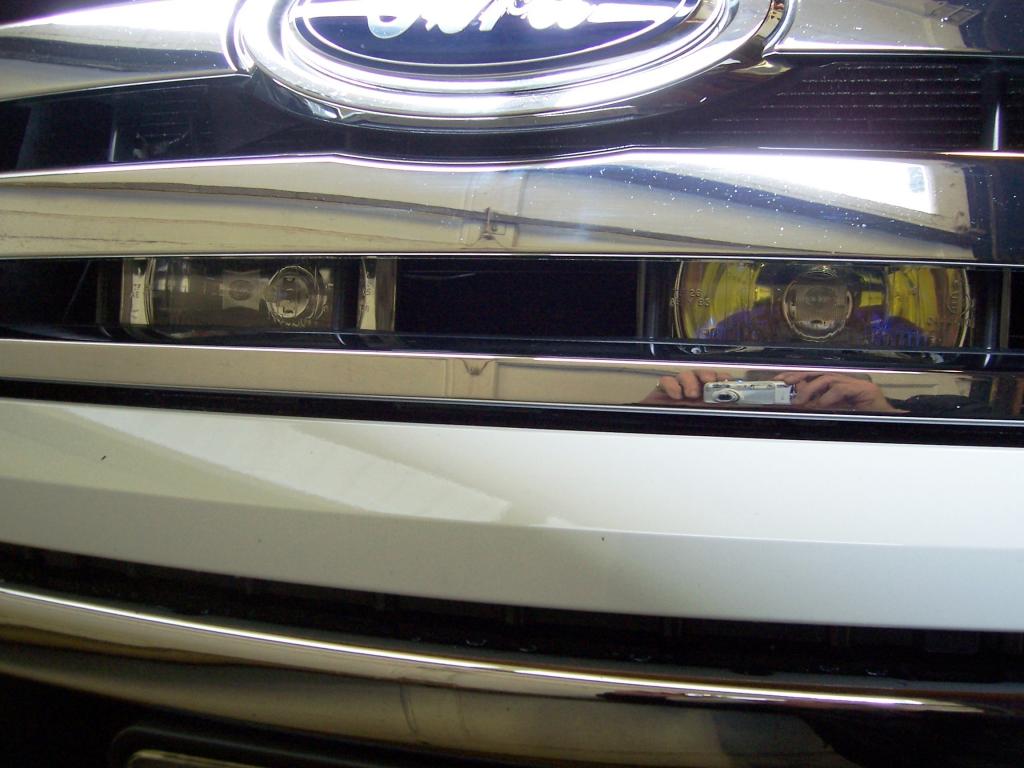

I did move the bracket and the lights back from the grill just a bit due to the higher wattage (and thus amount of heat produced) by the 100 watt bulbs.
How do they work? Initial tests show that they reach out a ton farther than the 75FFs, but I’ve still got to play with the aiming some more. Oddly enough, the grill does not seem to be hindering light output much. In fact I had the hood open to re-aim and watched the effect on the pattern as I closed the hood. Although it does cut down a bit, it’s not nearly as bad as I thought. So I’ll cautiously declare victory – or at least a big step forward – here.
