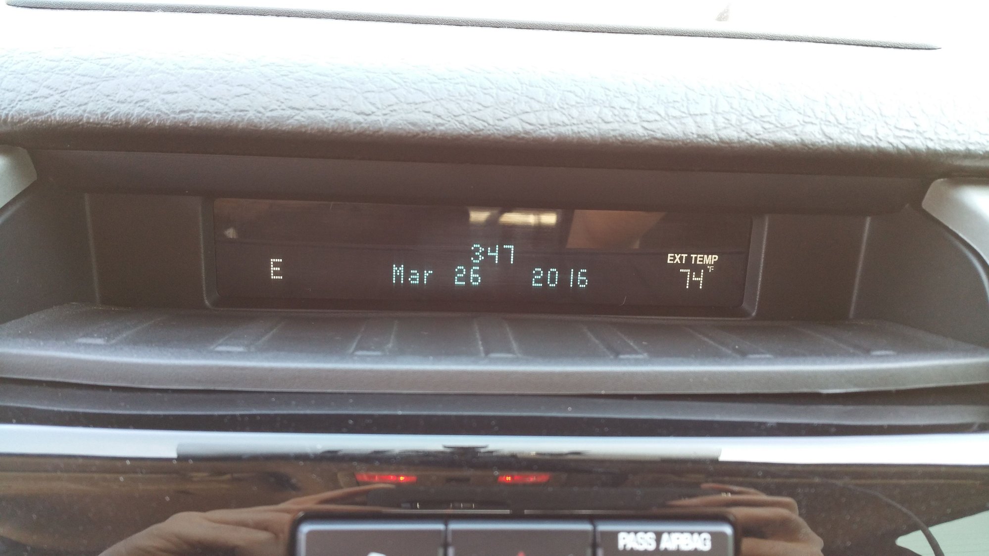

3. Stock SYNC Screen is Randomly Blank: This is a picture of the stock 09 F-150 SYNC screen.
Since having the Restyle installed, this is supposed to show the date/time as shown in the picture (The compass and temp ALWAYS show). This screen is randomly blank when I turn the car on. Sometimes the date/time shows up right away when the Restyle boots and stays on for the trip, other times it's blank for 10-30 min and then suddenly shows up, other times it's blank the entire time until the next power cycle. Again, Alpine support and my local shop have no clue why. My shop thinks it's a bug in the Maestro software that controls this. Alpine had no clue. Any ideas?
