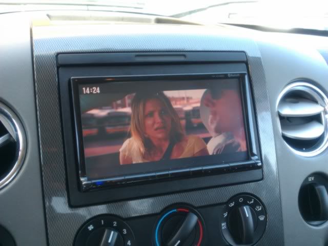

It should be flush. Is yours a double din headunit? If so it should look like this with the metra kit.
Threre are multiple mounting holes on the kit and the headunit. It sounds like you just used the wrong ones.
