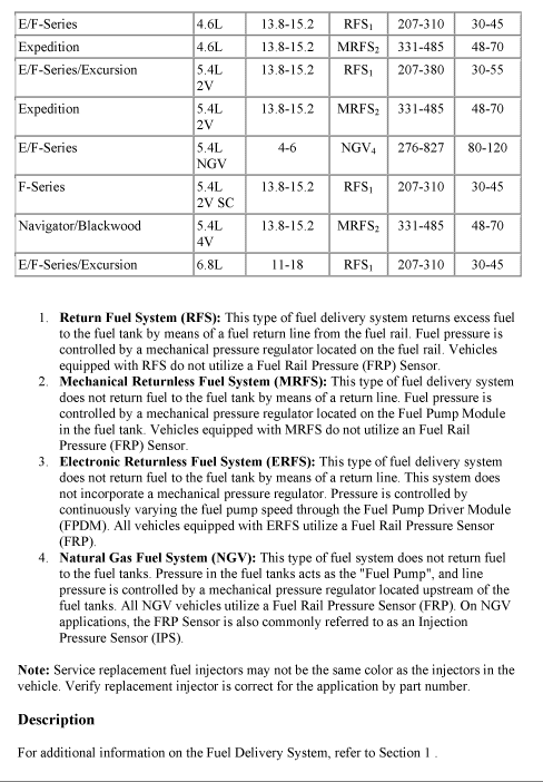

I would use a pressure tester, and check the fuel rail pressure.
Attached is a helpful chart...
