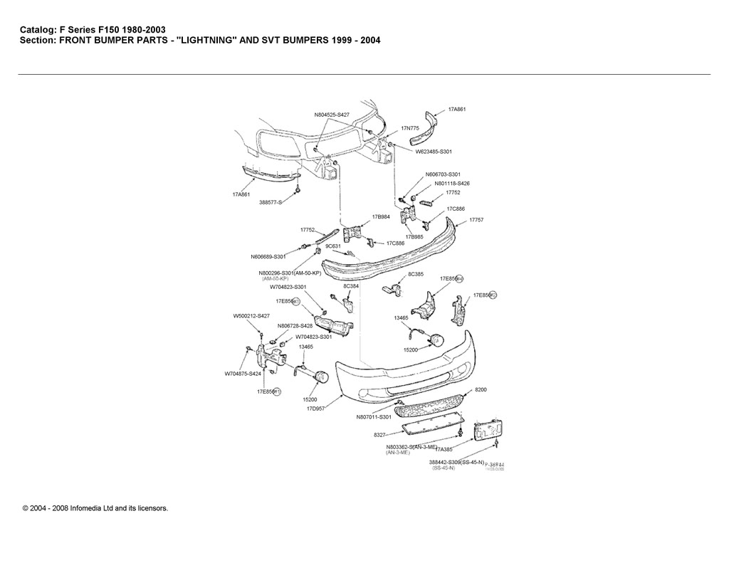

i just bought a harley valance off ebay and im a little lost on how to mount fog lights, is there a bracket that mounts to bumper or what?? and i would need two fog lights but i really dont see the piont in paying 300 or so bucks and not know if they even have to brackets so if i can get some brackets then a get a set of aftermarket light. im new to this forum since the other one i use is down and out i have a 97 f150 that i have converted the bumper and grille to the 99 to 03 model

wow that helps!! now my question in which will make me look stuid that shows the lightning model are the parts the same?? if so then i need a inner and outer bracket... and what do they attach to

lights attach to brkt, brkt attaches to bumper, bumper attaches to frame.
knee bone connects to leg bone, the leg bone connects to .......
lol

YL3Z 15200-AA
F150 list 209.28 sell $ visit my site
1980-2003
LAMP, ASY. - FOG OR ROAD AND 13200 [HARLEY DAVIDSON
VERSION, RH FOG LAMP/BRACKET ASSEMBLY- INCLUDES BULB
(PART # 94BZ13466AB), SOCKET (NOT SERVICED), AND JUMPER
(NOT SERVICED).]
YL3Z 15200-BA
F150 LIST $209.28 SELL $ VISIT MY SITE
1980-2003
LAMP & BRACKET ASY., ASY. - FOG OR ROAD AND 13200 [HARLEY
DAVIDSON VERSION, LH FOG LAMP/BRACKET ASSEMBLY- INCLUDES
BULB (PART # 94BZ13466AB), SOCKET (NOT SERVICED), AND
JUMPER (NOT SERVICED).

thats funny i havent heard that since anatomy class................................. got another question would STX model be using the same lamp assembly??

STX style are the same.
