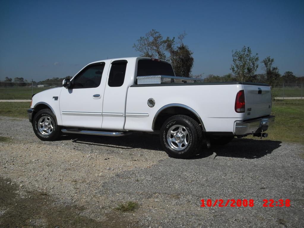

Howdy,
Here's my first post on the forum and it's a question for which I need an answer, so I turned to you fellas.
I am the proud owner of a 1998 F-150 Supercab that I purchased in 2008, that had only 67,000 miles.
It has been reliable and looks as good as the day I bought it from the original owner.
Minimum problems, I replaced the fuel filter about a year ago.
Buuuut, of late I have been having trouble starting in the mornings.
Crank and die, crank and die, crank and die...
I hold the accelarator down a bit, race the engine a tad till the engine warms up and voilà!
It runs perfect when it warms up.
Next morning same thing.
Any suggestions?
