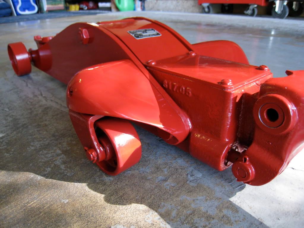

Originally Posted by 98Lariet4x4
From the looks of it, the model number is in the casting on the side above the rear wheel ( lower right hand side of this picture ).
This is a restored S17 model, the casting the model is clear to see.
Looks like a starting point could be :
garagejournal.com
Lot of guys over there that seem to spend a bunch of time and money restoring things like this.
Here is what the jack above took to restore
Thanks for all the nice comments. When I tore the jack down, I found that it was very heavily worn. Obviously the hydraulic unit had seen better days. The handle was bent and the yoke pivot pin and pump pins had a lot of play in them. The rear castor bearings were toast and the races were heavily worn. I also discovered a cracked weld at the lift arm pivot point and the frame was bent, I suspect from taking a very heavy shifting side load. After finding all the defects with this jack I almost didn't want to go forward with the project.
I had help from a lot of friends and new acquaintances. My son and I tore it down, cleaned and degreased everything. The frame was split, straightened and the cracked weld at the lifting arm pivot point was repaired and the handle was straightened. All of the hard components went into an electrolysis tank for further cleaning. I had new attachment pins fabricated for the handle yoke and the pump. New 1/4 " ball bearings and a thin machined washer place under the lower races brought the rear castors back to life. The hydraulic unit was rebuilt and load tested by a local shop. And finally, an etching primer and a single stage automotive acrylic enamel paint with multiple coats and wet sanding between coats was used to refinish it.
For me, it came out better than expected, but it's not going to become a museum piece, just a really nice and useful tool for myself and my son.
Hiball is currently on the look out for a set extension/retraction springs to complete it. Hopefully, he will be able to help out.

SSCULLY, I can make out an S17 on the side, but cannot find anything on the net about them...I actually created an account on garage journal right after posting here and asked the same question along with the pics... I'll let you know what I find out...

Wow, it's a S-7 from the early to mid 30's...This is going to be a fun project
