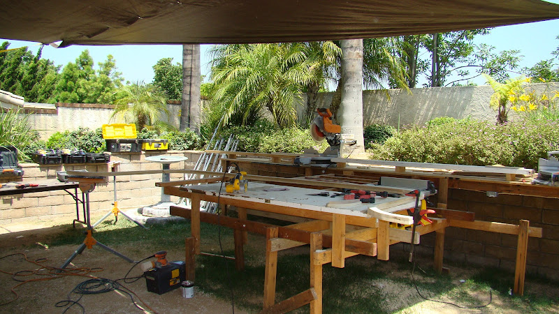

Yes,..... I know,..... most of you have seen pictures of the finish product when I finished remodeling my house about 2 years ago and a few of you have seen it in person. Since I've been organizing my picture's files and folders, I though I'd share with you what went behind the scene to create what most describe as a master piece.
For those of you who don't mind, I'll also be posting some more behind the scene of the Pea**** doors, (darn I can't even say peac ock in here!) music room, dinning room and buffet area. For those of you who mind, please don't click on my threads, thank you.
At any rate, I wanted to brush up on my ignorance so instead of going to the library I built myself a one.
Once upon a time I stared at this area and...aaa..........nothing came to mind. But I knew it would come to me so I took the last picture before tearing it down.
Poof! Gone!
After I created and built the vaulted ceiling I stood back and thought..........hmmmm.......to the right, double doors, is the entrance to our master bedroom. I can build an L shape wall to create privacy. Now the space to the left......hmmm........what can we do....................?
But later in the week it came to me............A LIBRARY!!!......Yeah!!!!.......that sound like a good Idea!
And so I pictured it with an arched entrance and fluted columns and a coffered ceiling.
Never built a coffered ceiling in my life but I thought I'd give it shot.
My first ever, coffered ceiling.
And so I began to add the color
Finished and installed it.
I also built my own cabinets and started preparing to install the columns.
I built the necessary boxes and supports and placed the columns to see what it would look like.
Then prep them to paint it white.
