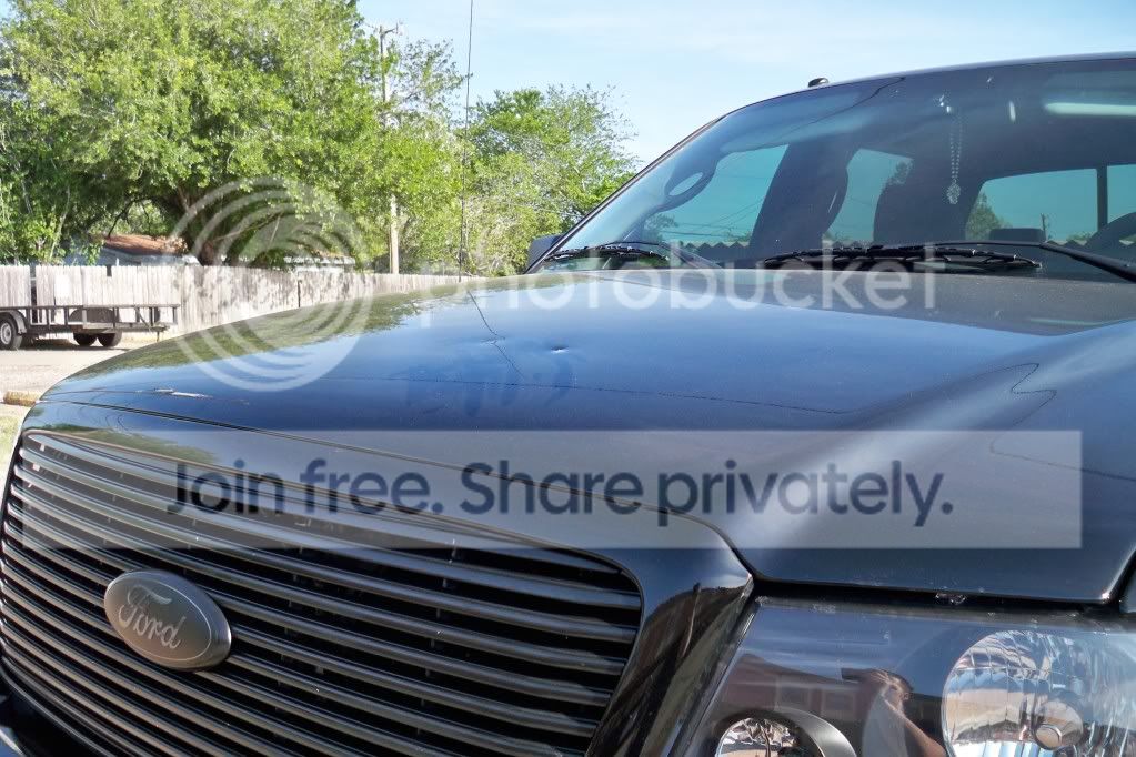

Well I stopped by the dealership a little while ago, and they are just about ready to finish it up.. it's gonna finished by the end of the day. It looks like b2therad and raptor were right about the paint blend. They sanded the clear down, repaired the area, and primed the repair. It looks good enough so far. I'm guessing repainting the whole hood might have been a better end result, but I doubt I'll be able to tell the difference when it's all said and done.
Here's what I've been driving around with for the past few months.. my DIY repair..
And here's a few pics I snapped with the repair job in process.

okok.. I picked up the truck from the body shop about an hour ago.. and it looks pretty good! definately worth the $290 spent gettin it done right.. most other shops in town were askin $400-500.. and this carries a lifetime warranty on the paint and workmanship..
anywho.. it looks spot on to me.. I'm assuming they did a paint blend, considering the repair pic, but I can't see any difference in color or finish, if anything the hoods finish has slightly less orange peel, but I'm not complaining.. in the sun or in the shade it looks good either way
Here's a few pics.. tell me whatcha think.
btw.. this was what it looked like originally.. before my DIY and professional repair..
