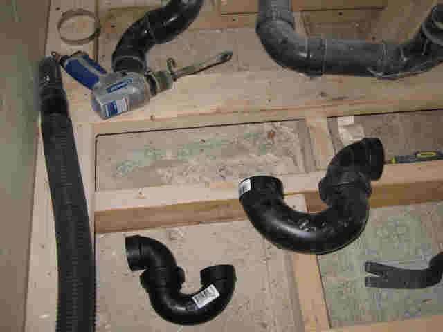

When the previous owner put in the drop in shower, he didnt add a p-trap. This of course made an awful stink from time to time. Now we decided to re-do the shower and when we asked a plumber out to clean the pipes, he pointed out the p-tran problem. Now I'm trying to get one in.
Sorry for the picture quality, I dont know what corel draw is doing to my image. Upper left is the current connect point. Upper right is what was connected. Obviously you can see both p-traps I'm digging in the center square and currently have a hole probably 2.5 wide, 2 deep, 6 long. I'm going to have to find a way to go at least 3 inches further down for that trap. The only other possibility is to go down another inch and ditch the 2x4 between the hole and the rest of the plumbing. Then the water would have to go down into the ptrap, back up out of the ptrap, down into the plumbing, then up just a little at the top of the image. The base of the drop in shower sits on the 2x4s.

UC, would it be possible to build up the base framing for the shower to give you the clearance you need? It may be easier to go that route. If not, happy digging.

Good suggestion but the ceiling is only 8 foot and I'm 6'2" so losing 8" or so is already enough.

Cut the frame out with a sawzall or something else and bust the hole as big as you need to put in the P-trap. Then rebuild your frame as needed.

My suggestion, to save money and still get the job done, I'd get a masonary blade for your skil saw, (assuming you already have a skill saw) cut a rectangle with it, then use your air chisel to wedge in the groove and bust chunks of concrete at a time out. May have to make a bigger hole so you can get the skill saw in the hole to go deep enough, but your going to have to buy an entire bag of quickrete any way. Won't take any longer to patch back up.

If it were me, I would take my twelve inch chisel and my three pound sledge hammer and puch a hole in the cement. Then do another spot. Continue to do this and you will eventually have room for the trap. The air chisel that you have, is similar in size and ability to the Bosch that I have on my truck. It's too small for the application. A bigger mechanicle hammer would do the job pretty quickly. We rent bigger mechanical hammers because many consider them "self destructing" tools. I have the hammer and chisel to do the job manually though.
Six hundred bucks seems like a lot. If you have a bunch of other stuff that needs to be "corrected" (like that old house I mentioned in a previous post) then maybe it's ok. If you don't have permits then you should keep trying. I think you're almost there. It might require some blood, sweat and tears, but not a bunch of money.
