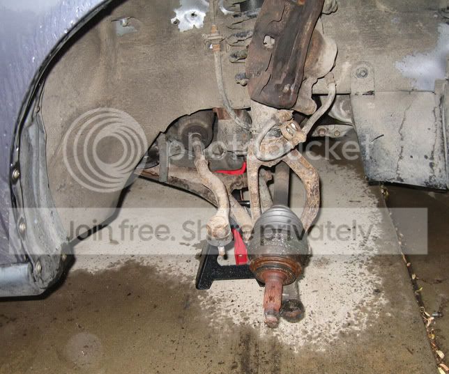

Don't try this at home. I spent another 8 hours on this project over the weekend. The worst part...... trying to tighten nuts on a ball joint to 80 ft/lbs. Ball joints move you know? Here are my final notes.
Manual Shop Press.
Hardest Part: Getting steering knuckle to sit exactly balanced/flat whatever. If it's not exact, or very close, the bearing tries to press in crooked. What a pain.
http://www.northerntool.com/images/p...s/14590_lg.jpg
Here's the old bearing. It is missing a portion that covers the ball bearings. That part didn't press out but rather remained pressed to the wheel flange.
We had to cut it off with an angle grinder; careful not to damage the flange.
Here's the new bearing. As you can see in this; the inside is a two-piece design as noted above. I had a similar problem when trying to press in the new bearing...half of the two pieces came out the other side when I pressed it in. Talk about a poor design.
Here's a close-up of the bearing. I highlighted in yellow the axle flange (From yellow inwards). Not only is the bearing pressed into the steering knuckle, but also the axle flange is pressed inside the bearing.
Axle flange from the front
http://i72.photobucket.com/albums/i1...IMG_0913-1.jpg
With the steering knuckle removed.
NEVER open the axle boot. BAD idea.
I had to use a pickle fork, as mentioned, to remove the steering knuckle. This process damages the ball joint boots in all three places. Upper ball joint, lower ball joint, and steering arm thingie. If I leave it as it is now; I think the ball joints will fatigue due to lack of grease sooner rather than later.
