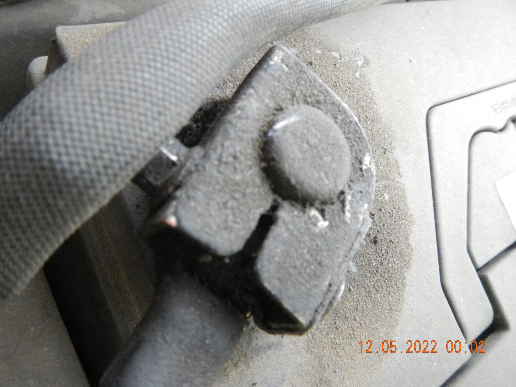

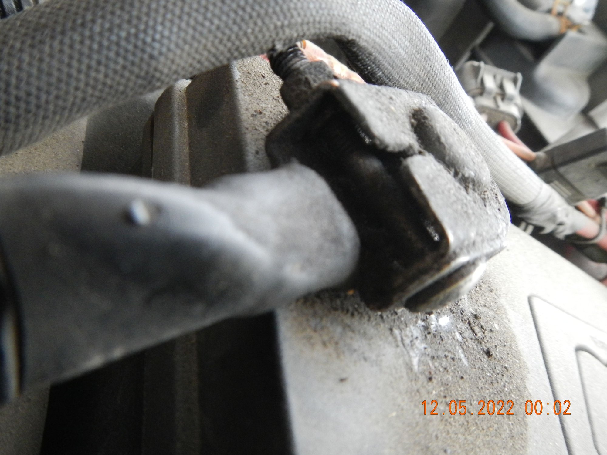

I took these pictures of the two battery posts with cables attached today. They look even dirtier up close in the pictures than they did while I was looking at them, along with both cable connections being loose... I am pretty sure when I clean those connections up and tighten them down tight that this is probably the problem. If not, then the battery itself.
I didn't have a way to test the battery or the alternator today though.

Get it cleaned up and started and go to a parts store, they can test them in the parking lot.

Don't overthink this.
1. Fix what is obvious. Clean up all those connections and clean the top of the battery.
2. As previously suggested, load test battery and verify the alternator works.
