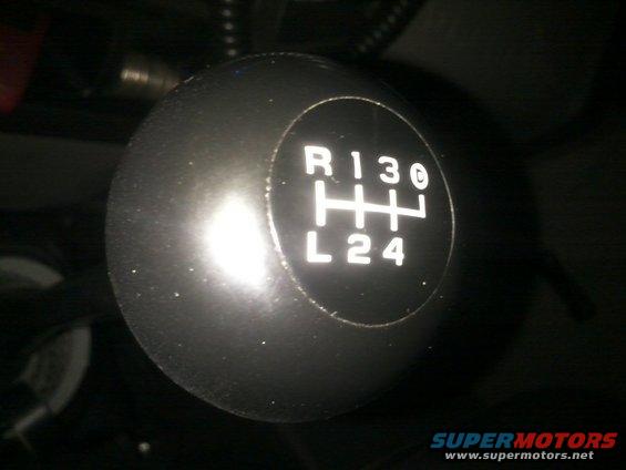

Yes and no. The '97-'03 half ton body style was the last year for a 4x4 V8 five speed M5OD-R2. The '04-'09ish could also be special ordered with the M5OD-R2, but only with the V6 and 4x2. If you want a stick you gotta get a superduty from '99 to '10. with various years having different combos of the big bomb proof S5-47 or S6-650

Well, you just have to step up to an F-2/350 before '11. Absolutely love my '08 ZF6 other than being 4x2. No matter what the others say, I'll always think my left foot will do a better job than a torq***** computer.
The granny low and R being right inline like a big truck makes parkin' a trailer super slick simple, and I'll never trade this truck away simply for being the last six speed motor combo available. Even though the 6.7L has advantages over the 6.4L, I won't make the jump to slushbox.
