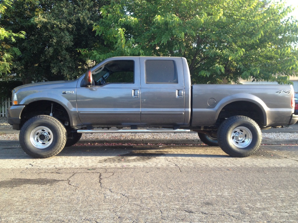

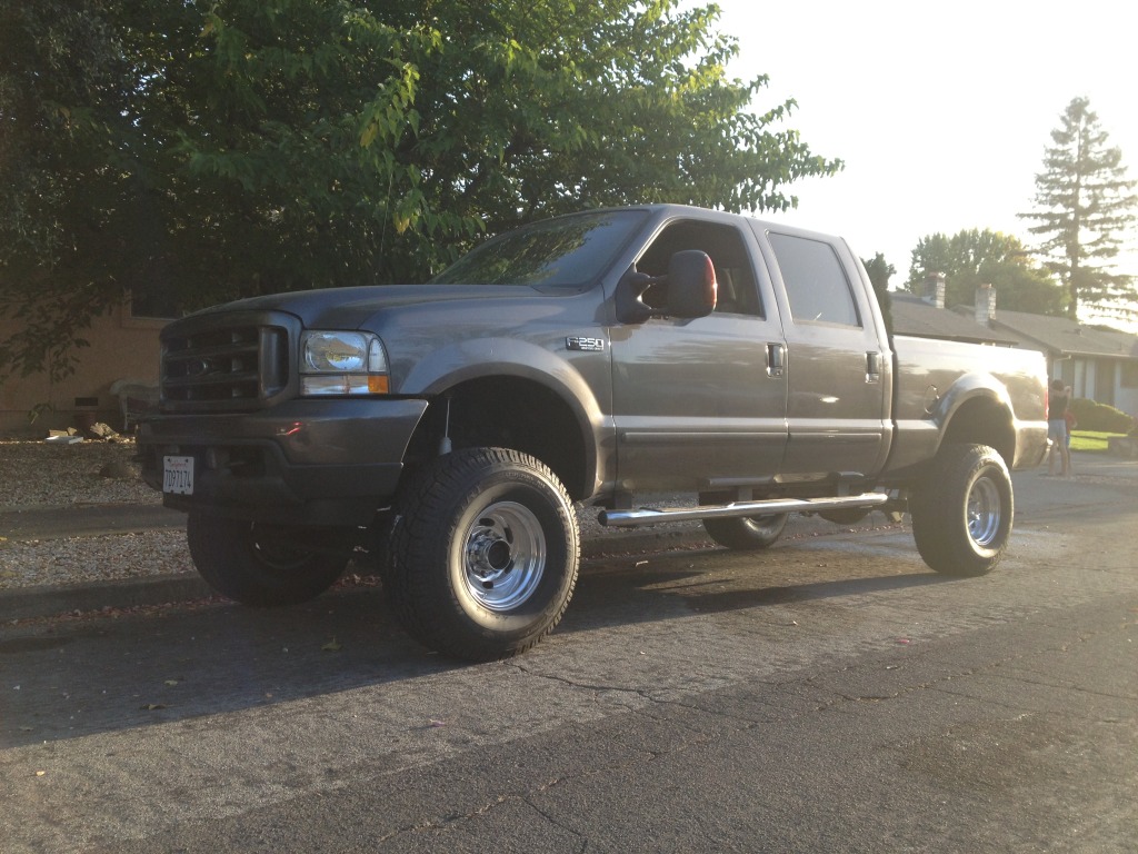

So I recently finished an install of a 4" suspension on my 2003 SD.
Install went fairly smooth for doing the job solo. However after the job was finished I noticed the front axle is pushed forward quite a bit!! I installed the leafs just like the stock springs were installed with the large spring eye up front and the smaller in the rear shackle.
I'm assuming I did this right but question whether or not the axle should have shifted so far? Here is a recent side photo that clearly shows the forward stance.

Anyone experience this after a 4" lift?
Thanks in advance

That looks right from the pic you have. Is the pinion angle down or is the driveshaft at a bad angle, if not you shouldn't have nothing to worry about.

Everything checks out. Pinion angle is down, but no more than expected after adding a 4" lift. I just got the truck back from the shop after getting an alignment. They didn't see anything wrong or out of place. The truck drives very well.

Truck looks great. I think you are fine.
