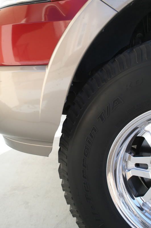

Well I have an 04 EB with 17x9 and 4.5 backspacing and I am clear on the inner fender area but rubbed on the outside. I trimmed off about 2 inches from the front bumper cover to give it a nice roll versus the sharp down turn. also had to pull the factory running boards because they overhang a bit
