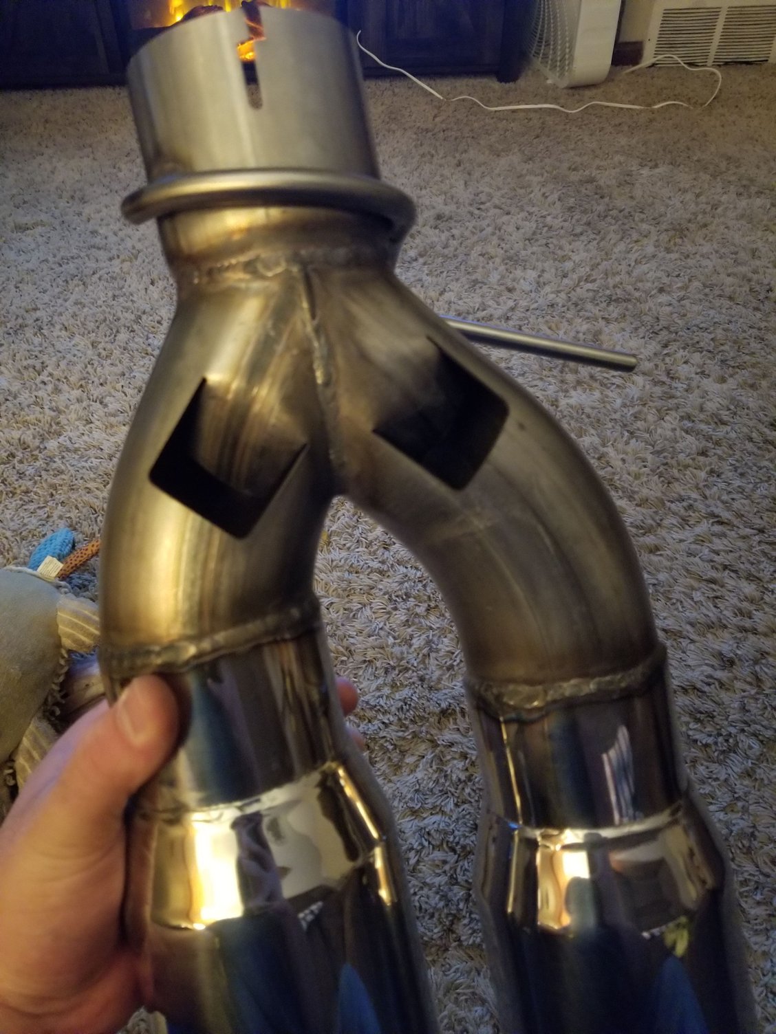

Roush Exhaust Noise Fix
Originally Posted by Tyler5157
"Talensafe" I have the same issue on my truck!
2022 F150 5.0 with the active kit Roush exhaust.
"TruckGuy24" Can you send me the info as-well.
Thanks Tyler
I emailed Roush Customer Service at
rppcustomerservice@roush.com
Described what was going on and they said that it is a known issue with their exhaust.
They said its caused by the dual exhaust tips.
I was told to open a warranty claim with a Roush certified dealer and they would send out a new set of exhaust tips.
My dealer was booked up for a few weeks
I expained that to them and asked if they could just ship the tips to me directly. They asked for my VIN , Odometer reading, and address. I got the tips about a week later.
I don't know if they'll do that for sure but I was lucky enough to have them sent to me. Just an exhaust clamp that holds it on, no welds so it's an easy install.
Also I bought my truck with the full Roush package from a dealer that's why they needed my VIN and Odometer reading. So it might be a different process for a non Roush package, if you just have the exhaust. But I would think they would take care of it either way.
I'll attach pictures of the new one they sent and the part number. The only change I can tell is a vent on the bottom side of each pipe after the Y in the tip.
PART# PT00046023-AA
These are the vents they put on to stop the noise.
