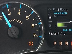

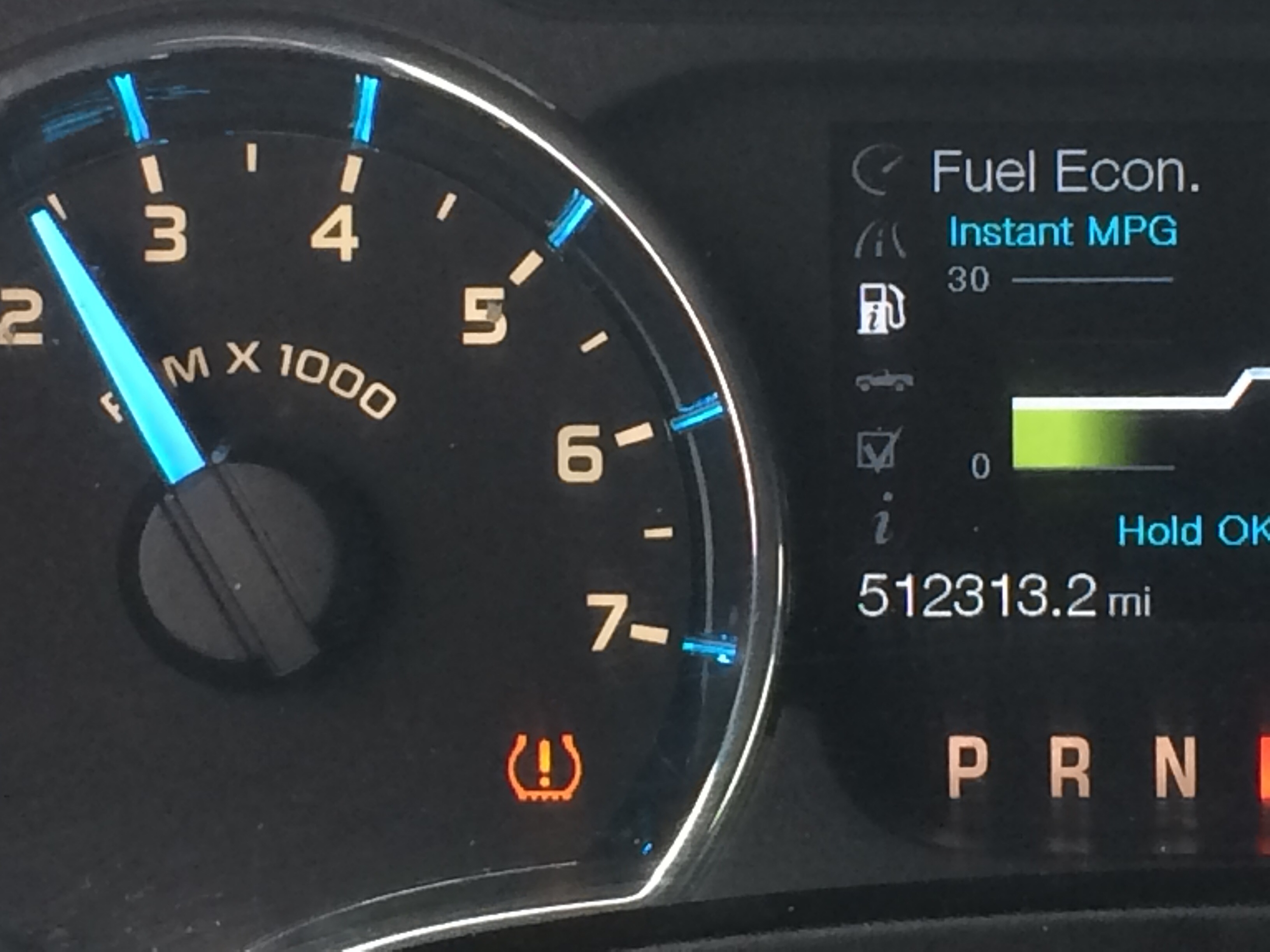

Ahh that would explain it then I hadn't no idea where o got that it was a misfire code!! That explains why it didn't help changing the plugs and coils and yes though it's about 80000 a year it is a. 2011 and I'm actually now at 511989! And that's all my driving I drove it off the show room lot with 9 miles!! And as I've started to say these are the only issues I've had, well except new rear end at 400000 and for sone reason drivers side rear brake light and directional decided not to work anymore, tried rewiring them and nothing

Just uploaded a picture of odometer, because most don't believe that I have that many miles on my truck!
