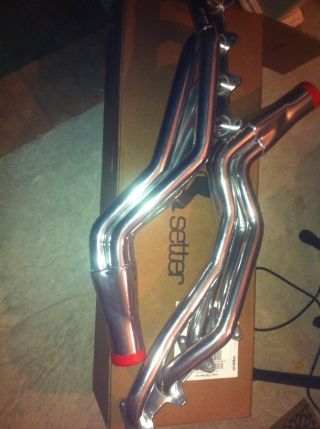

Here's a pic of the headers:
Thankee, sir!
I bet the black wasn't black fer long, huh? I ALMOST just got the black ones because we see almost no real bad weather in the winter anymore. But I found these at a very good price so I couldn't pass it up.
