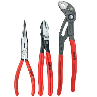

Use some long neck dykes to get in there and cut it up. The flex tubing is glued to the 90* plastic elbow.
like the ones in the middle
once you start cutting it, and rolling it over itself like a burrito. you will see that the ends are flared, and there is a side pipe connection into that outside ribbed section of the elbow that you can see from the underside of the intake tube
