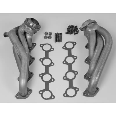

Shorties aren't nearly as bad as folks like to automatically throw out there either, its just that most aren't well designed. The main problem is in the ball and socket collector and shorties that dump all the tubes together right before the collector. A well designed shorty can make more power than a longtube, which due to the tube length are better at promoting torque. The Edelbrock shorties look like a very nice design, all the tubes are merged together before the collector.

Like I said, you need a well designed shorty.....if I remember right the Gibson's dump all the tubes right into a ball and socket collector just like most of the others.....
I should have been clearer too, shorties have potential to produce more high end power, not a better curve overall, because of the shorter tube length. Similar to intake manifold runner length, header tube length dictates where in the powerband you get the best results.
Take a look at the Ford Racing shorty and the poor collector design.....
and the Edelbrock.....not as good as a typical longtube collector but far better than most shorties....
People get way too hung up on tube length and size when a poor collector design can have a much larger effect.
