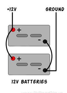

I looked into the solenoid method but they are triggered off the ignition. Most of my accessories require the ignition to be ON which defeats the purpose. That's why I am looking at the manual switch method.
Here is how I am wiring it...
I will put the switch and fuse between the 2nd battery positive and 1st battery positive. Is 100amp enough?

Why not run a battery isolator set up? It will automatically charge both batteries and you can determine what each does without drawing power from the other. Put the radios and lights on the second battery and the other as the starting battery. I have run that set up many times for competition audio. The nice thing about is when you use the accessories it wont draw from the starting battery. The other nice thing about it is if your starting battery dies because of headlights or some other oops, you can give yourself a jump from the secondary battery.
