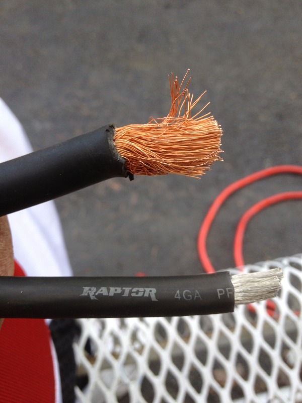

I use this stuff for everything:
1AWG welding cable. This stuff is close to being as conducive as 1/0 and 2/0 knukonceptz, raptor, or other overpriced audio wire. Its >99% copper, no aluminum alloys, oil and heat resistant coating, along with thicker stands.
Video showing Big 3 output with engine off and at idle with headlamps on.
Video showing Big 3 output with engine off and at idle with all inside accessories on, and 30watt back up lamps.
NOTE: Meant to say alt. tends to put out 14.4 in a real world. This is a miscue in the video.
Voltage drop at the amps.
