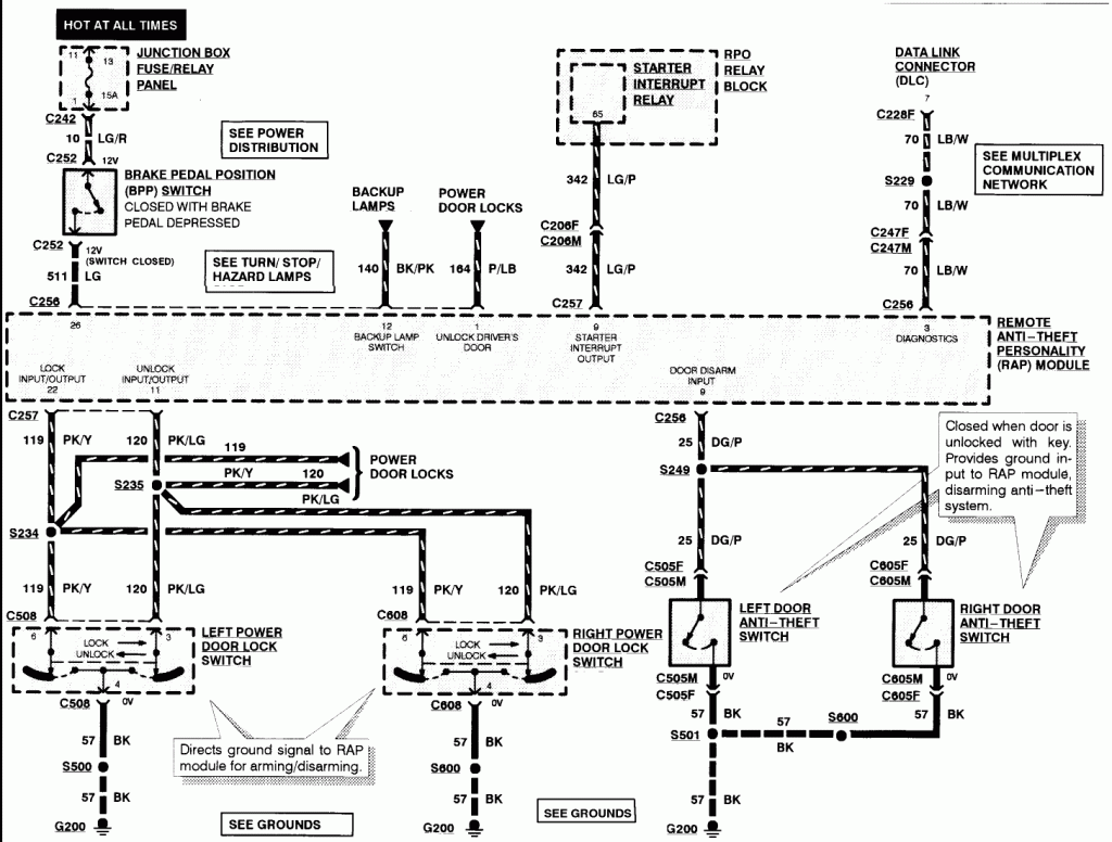

is there an antenna wire that i can patch into on the RAP? if i hold key fob up to it will lock unlock no problem, take a 6" away will not work, i got wiring diagrams they show an antenna but took out RAP and there is no antenna wire that i can find.... any help
