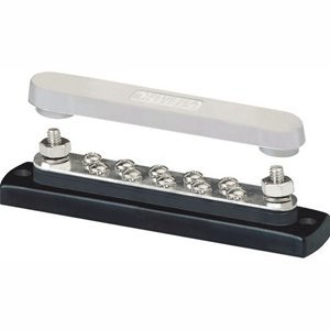

You could always use a busbar like this:
12-way Buss Bar
Automotive Buss Bar
