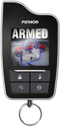

That's a good price. The 1601 looks pretty good. I just had a buddy order the Python 1091 from Travis a few days ago that I'm going to be installing for him. One thing about Travis is that he does not compete with the low ballers. He's a one man army with a small business to take care of his family. He not only runs his website but also installs locally in Kansas City for nearly 12 hours a day lately. He sells a quality service with a WARRANTY to back it up.
Here's the one my buddy got for his Silverado
