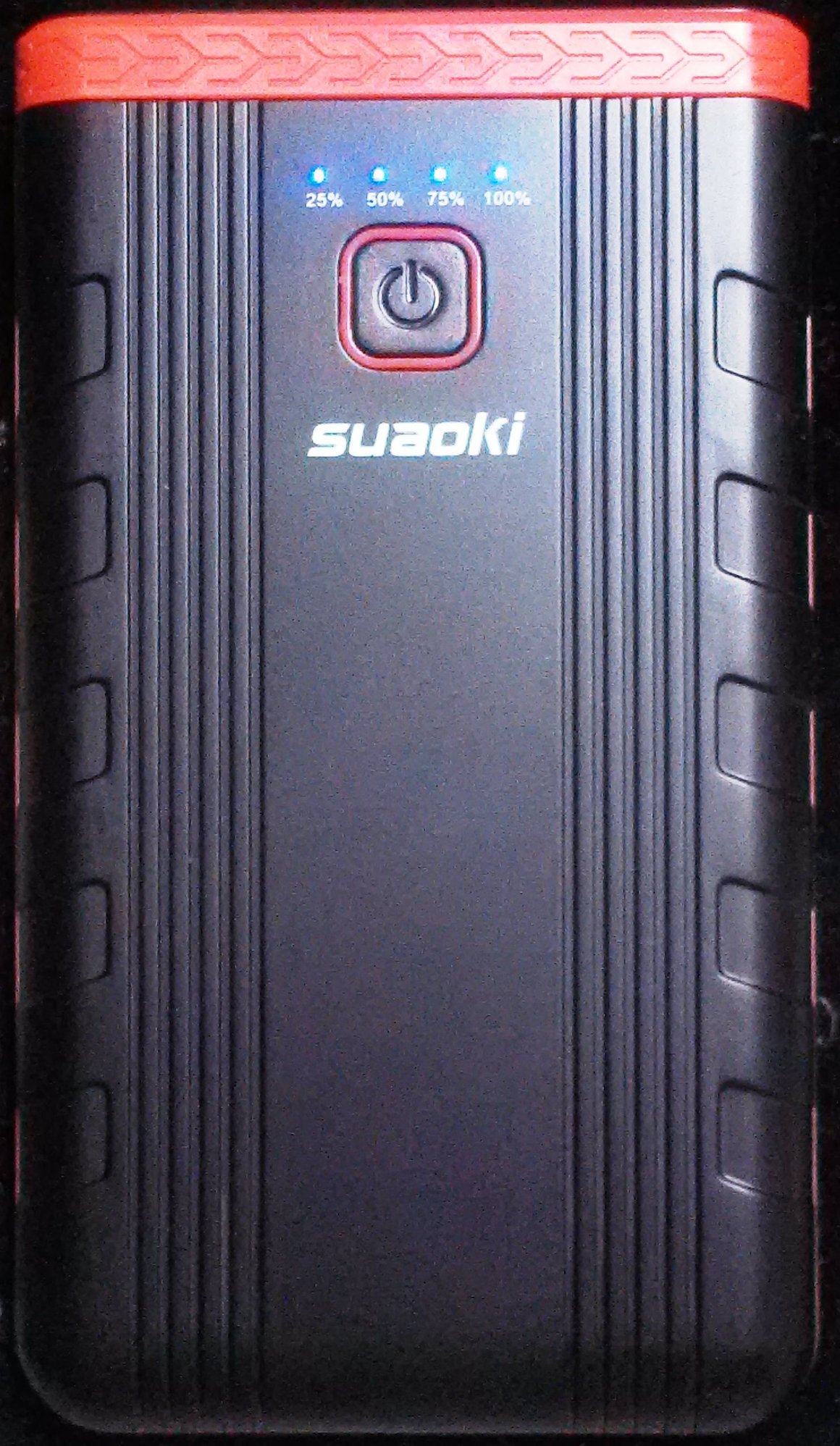

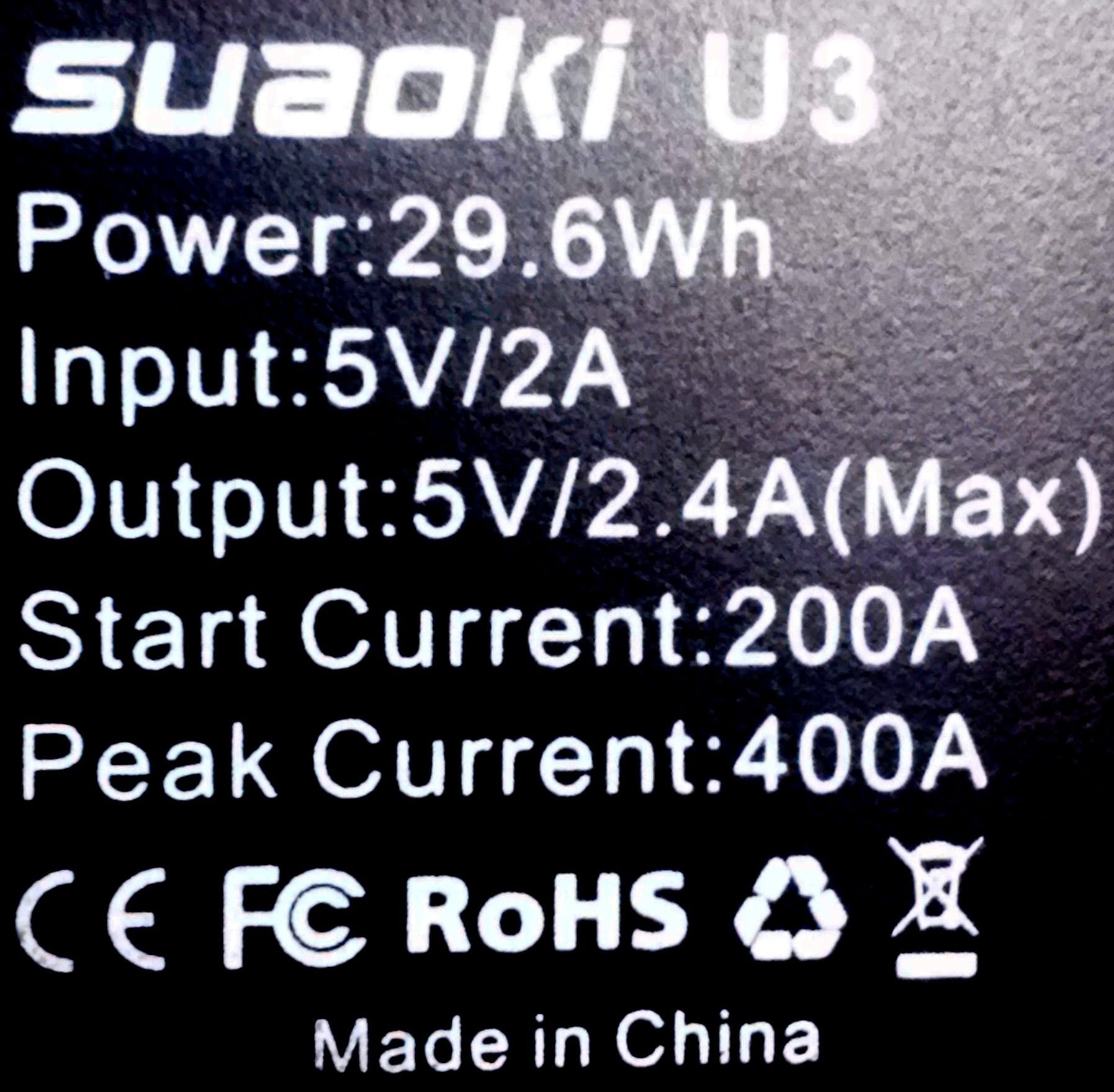

The hardest part is deciding which one to buy. The Optima RedTop has 800 Cold Cranking Amp. The Ford Motorcraft BXT65850 has 850 CCA. So if your truck is not starting with an 850 CCA battery, you will want your jump start device to be higher than that.
Very inexpensive models can sell for as low as$25. 200 CCA will probably start my motorcycle. It's nowhere near good enough to start a light duty, 1/2 ton truck. For the low price point when they go on sale, this unit is handy to keep in your purse for charging your cell phone. Seller claims that it will jump start an engine up to 2.5L. My Transit Connect has a 2.5L engine, with the OEM Ford BXT40R rated at 590 CCA.
After trying several lithium battery jump starters, and sending them back, I am now using 2 models, from the same brand. Genius Boost. GB40 & GB150.
