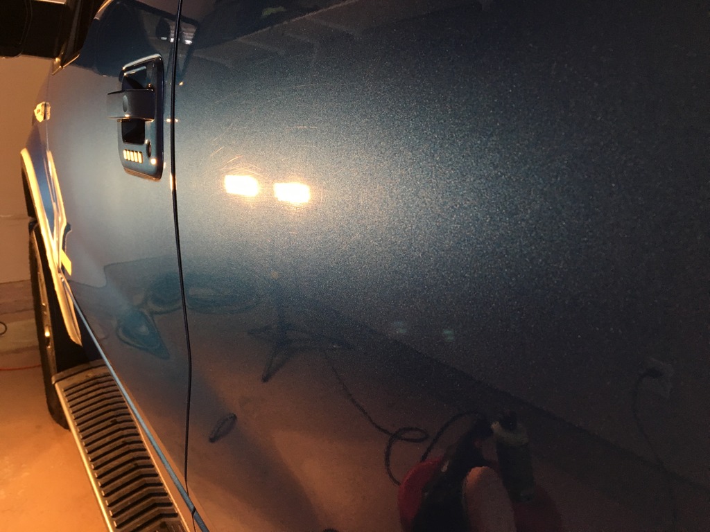

I was able to get the truck done over the weekend. Lot's going on so had to take time in bits to get it done.
The focus was solely on the paint, so the trim, wheels, wheel wells, etc are all still un-detailed.
- Two bucket wash with Meg's MF mitt and my new Grit guard washboard
- Clay with Nanoskin mitt with ONR @ QD ratio
- M101 on a 0rang LC smart pad (5")
- Chemical Guys V04 on a white LC smart pad (5")
- Poor Boy's Liquid Red by hand with foam applicator
- Menzerna Power Lock used on Mirror Skull caps and bumpers
Products used
Paint before. Mostly deeper marring, not much in the way of swirls
Tape job
After clay, I went straight to the V04 on a AIO Orange Superbuff pad. It did have some cut, but not enough to get out the marring I had. So I moved to a LC Orange pad and M101. The V04 is VERY thick and took a bit of dialing in to figure out how much product to put on the pad. I would say it's cutting power is a bit less than M205. I did a ISO wipe down to see what there was for fillers and it didn't appear to have much. It did go on ans come off pretty easily. It didn't leave a very "slick" feeling paint behind, which I didn't like. I wasn't sure on the protection and wanted to try out the liquid red, so that was the LSP. Liquid red was really, really viscous. It soaked right into the applicator pad, I've never had a wax that was that thin before. It did make it really easy to apply super thin and removed very easily.
Liquid red prior to removal
Overall, very happy with the end result. the Liquid red left a very nice slick feeling paint and added very nice depth. the paint looks deeper and more "liquid" than when I use Menzerna PL.
