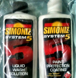

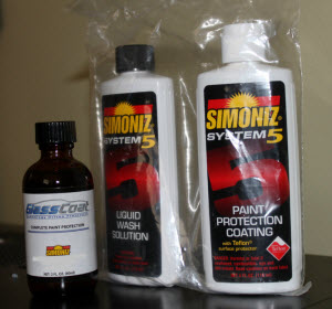

I received three products in the package
Two System 5 products and the Glasscoat.
Liquid Wash Solution & Paint Protection Coating
System 5
Liquid Wash Solution 4fl oz
Clear Pink/Red in color.
The bottle states to add it to one gallon of water
I'm not sure what it's real purpose is besides cleaning the paint.
Paint Protection Coating 4fl oz
White cream like product.
The bottle states can be applied by hand or machine
I applied it with a PC speed 3 with a 5" LC black flat pad.
The bottle states...Remove with terry bonnet on orbital.
I found this the easiest way to remove the slightly stubborn product.
Results (so far) after application.
The Wash Solution was a good product. I'm not sure if it's "special".
The Paint Protection Coating left a slightly darker and slicker finish.

It was suggested to me to wait after PPC before applying Glasscoat.
"Glass coat is the last thing after you apply the System 5 coating.
System 5 acts the same as Glasscoat but for a short period of time.
When you apply both you're building two layers of paint protection.
Be sure surface is dry, dirt or dust free surface before you apply the PPC.
After you apply PPC let it dry then remove it with a polishing tool."
(PPC dries hard and white and is a bit too stubborn to remove by hand)
"You need to completely remove any PPC substance on the surface.
Wait approx. 30 mins then apply Glasscoat.
...it is not necessary to apply glasscoat after ppc. You can use it on your next wash"

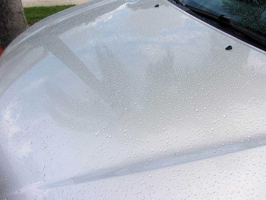

This stuff actually sheets water. It's not for tiny beads. Oh Boy another picture of water beads!
NOTE: It started to lightly rain about 20 minutes after I applied it and here's what it looked like.

Is the product good?
So far (3 weeks) I'm very happy with the look, feel and water repellent results.
I'm not sure if it will live up to the seven year longevity marketing hype.
I'm sure dealerships sell it (interior/experior package) with the warranty for a large markup.
The keyword here is warranty. This is actually where the dealer cost/markup comes from.
As a product for the exterior paint (so far) I give Simoniz Glasscoat a thumbs up!
