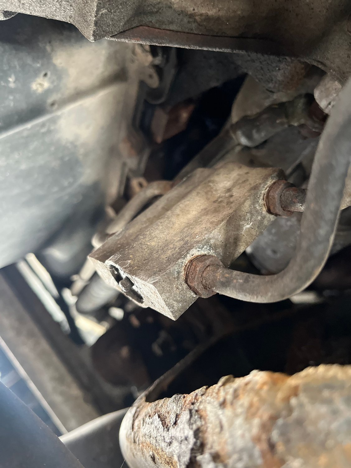

What is this part beneath the starter?
Hi,
My name is Justin. I’m getting ready to replace my starter as I believe it just went bad. I have power and lights in the cab but it will just click and not turn over. I checked my battery and the fuses. I think the starter is the issue. When I went under to look at it I noticed this is in my way. Can you or anyone tell me what this is? I would need to disconnect this to get to the starter.
thank you
