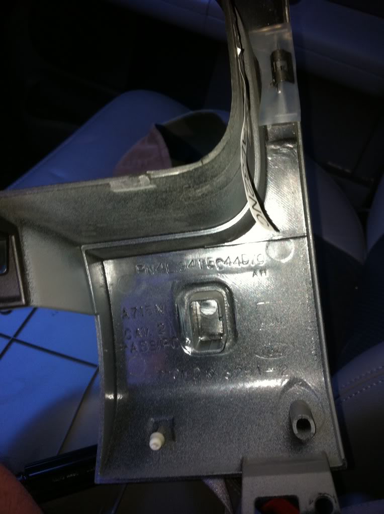

That's awesome, I was also told It would cost 300+ to fix it. It took me 10 min and it fixed it! One question though, I have a wiring harnes hook up right to the left of my stering wheel behind the pannel that covers the guages. Any Idea what it is too? It has a plastic holder in the panel that keeps it from moving around.I think it is for the option to move the pedals. here are afew pix.
This is where it plugs into the plastic
This is the plug

That's what it is- the adjustable pedal plug. I'm assuming you obviously don't have adjustable pedals.

From: Millington Tn
No I don't but might look into getting them if all I half to do is plug and play.
