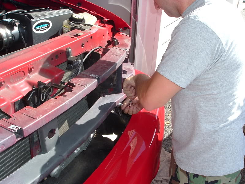

Once you've removed the final bolt, you can then remove the grille support. Here's Jeff getting his hands dirty...

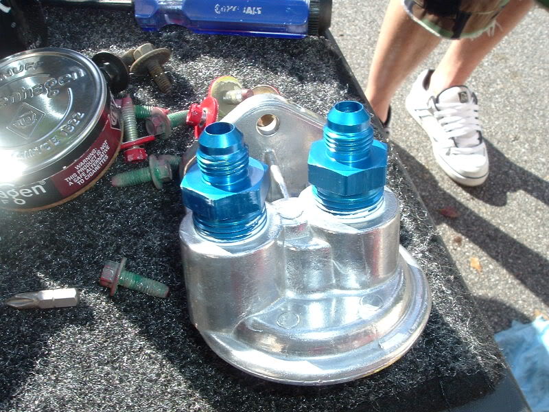

Then we installed the oil filter mount. We were going to install it in the same location I have mine (wheel well) but we decided to install it to where the filter would be behind the Heat Exchanger on the passenger side. I just made my marks with the Sharpie and drilled some pilot holes for the sheetmetal screws I used. You'll need to use a wrench to install the two outside screws because there isn't enough clearance to use a ratchet. I was able to use a ratchet for the center screw but I had to use an extension. Pics of it installed are later in this thread...

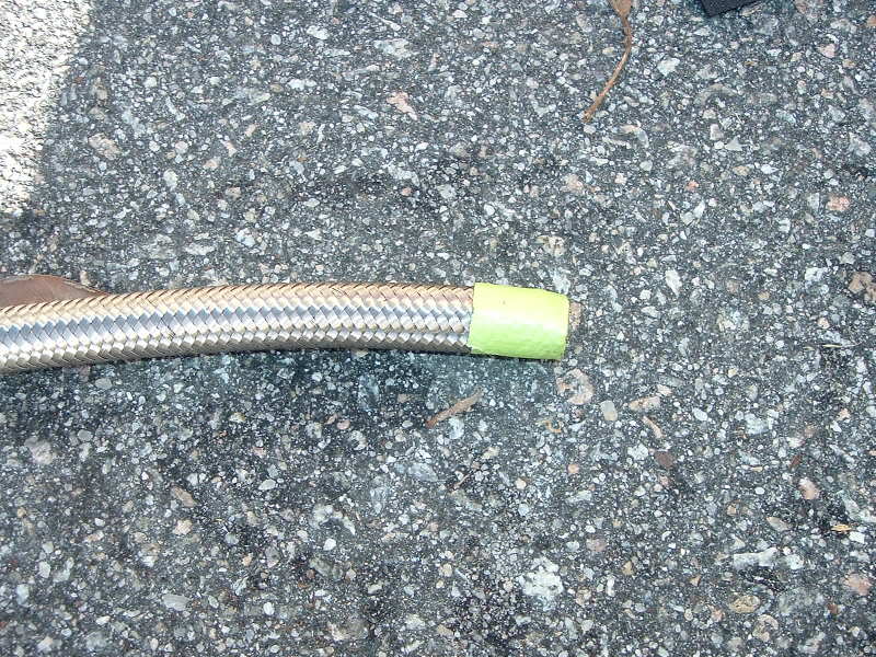

First wrap the hose woth some kind of tape to prevent the braid from fraying when you cut it. I used painters tape...
Then cut the hose in the center of the tape to you'll have the tape on both pieces you just cut. I use Summit AN Braided Stainless Steel hose cutters to cut my hoses. They cut great...

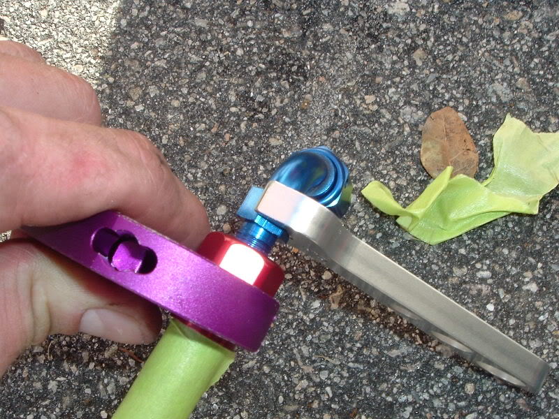

Then apply some lubricant to the male end (blue) of the AN fitting. In this case I used good ol pipe thread sealant...
Then push the male end of the AN fitting into the female end until the male fitting penetrates the hose. I also marked the fitting in relation to the hose with some painters tape to ensure the fitting wasn't pushing the hose out...

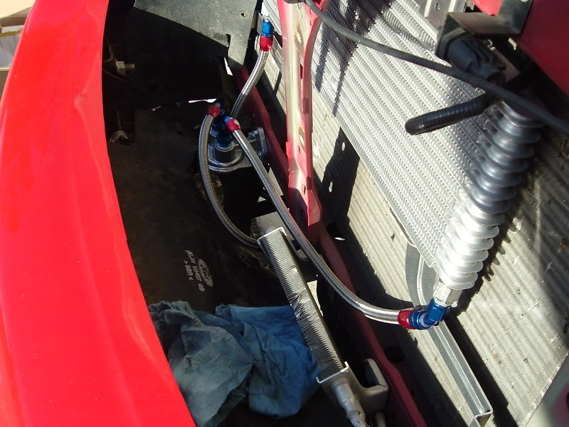

We decided to install the hose from the feed line to the inlet port of the filter mount next. It's important to install the filter before the cooler so that in the event of a transmission failure, the debris will get caught by the filter and not contaminate the cooler.
We used another section of Russell -6AN Proflex Hose. We also used one Russell -6AN Hose to Female -6AN 90 Degree Hose End Fitting (Part # RUS-610160) and one Russell -6AN Hose to Female -6AN 45 Degree Hose End Fitting (Part # RUS-613090). I used the same procedures mentioned earlier to assemble, measure and install this hose...
Then we used another section of Russell -6AN Proflex Hose, another Russell -6AN 90 Degree Fitting and another Russell -6AN 45 Degree Fitting to assemble and install the hose from the outlet port of the filter mount to the drivers side of the cooler. Here's how it all looked once we finshed the plumbing...
