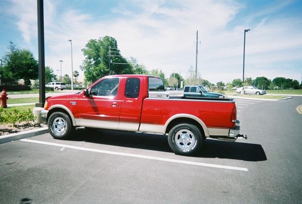

Here's an idea of what to expect. My old truck, 2wd with a 2" Daystar level, 285/70/17 tires. No modification to the rear necessary, no rubbing in the front.
