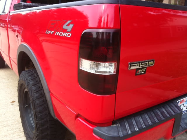

Lifted5.4Lariat's Avatar
Joined: Mar 2010
Posts: 2,126
From: Ponca City, OK
Thanks guys. And yeah i'd just stick with having him use his clear. Heres one with 3 coats.
Old Dec 18, 2011 | 06:35 PM
Barrett's Avatar
Posts: 2,777
From: San Antonio, Texas
Is there any on the reverse light on those?
Old Dec 18, 2011 | 07:24 PM
Joined: Mar 2010
Posts: 2,126
No, they are a set of the Harley's I have been selling.

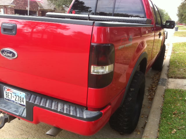

Old Dec 19, 2011 | 01:15 PM
97isnotold's Avatar
Joined: Oct 2009
Posts: 1,224
From: Conroe, Tx
Originally Posted by Barrett
Got any pictures? How long have they been holding up for so far?
they've been holding up for a good 3 months now lol they hold up to being covered in mud and being powerwashed clean
