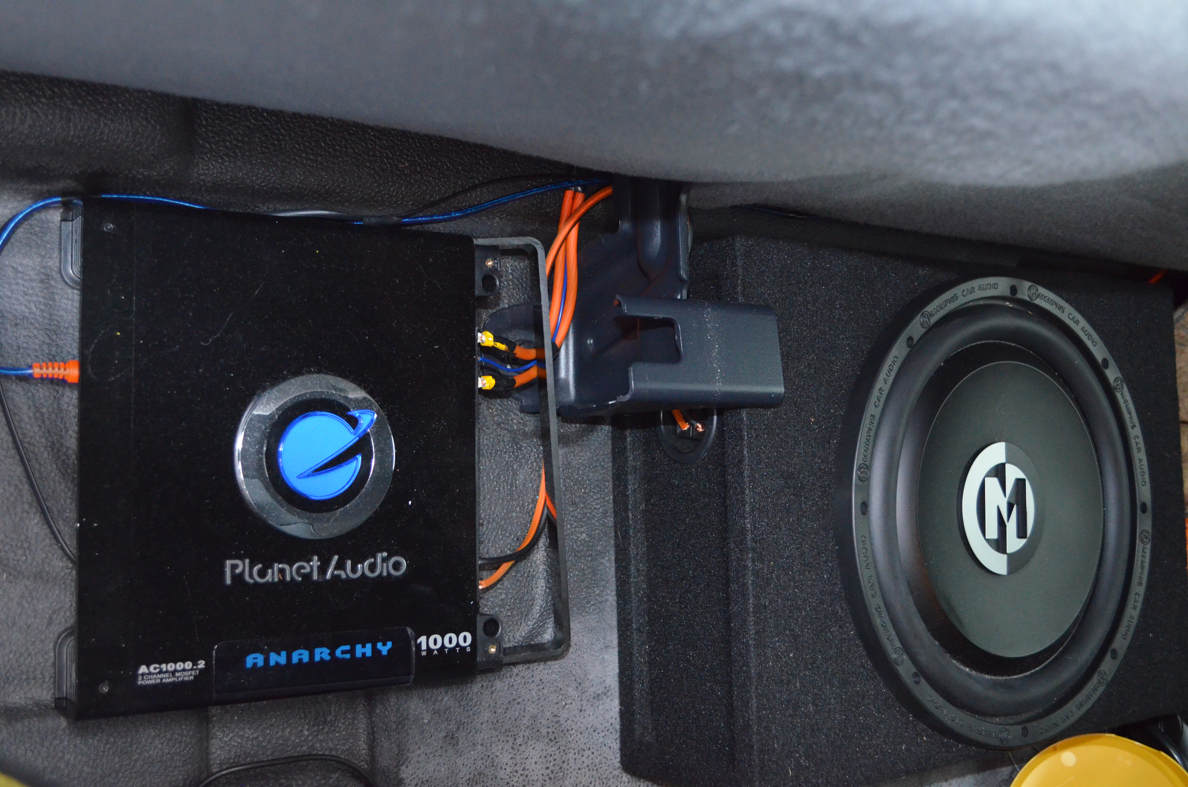

ok I had an amp installed. planet audio 1000w 2 spk. What is the recommended size fuse for the battery wire going to amp??
The one that was there was a 10a fuse. that fuse stopped working but was not blown as far as I could see. did test fuse
in the fuse holder and no power would come thru the fuse to the other side.
The fuse actually on the amp is 25a should it be at least that or higher for the battery wire
amp and sub that was installed
thanks

well it was a 100 amp fuse not a 10. yes it is dead,, the fuse, took a dmm to it. I stuck a 40a fuse in it an it works. the 100a fuse is gold covered not sure if that has anything to do with it. also moved away from the top of the raddy,, it was getting heated.
