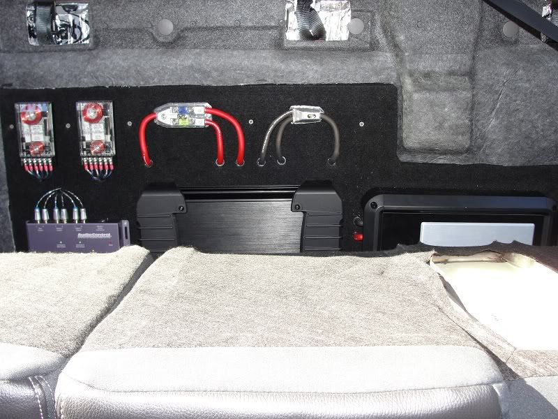

Like most guys I mounted my amps on a piece of MDF behind the seats... works perfect.

Two amps mounted on 1/2 MDF, painted blue. Board was mounted to back wall over sound deadening. Then a layer of MLV was put on with the board space cut out, finally the outer foam cover with the same board cut out. There is a horizontal rib that runs along the back wall. I used two screws mounted into this rib. Make sure you don't use too long of screws, otherwise they will be poking out the rear wall.
The thickest amp is 2.5" and I would have issues with anything thicker.

...except I used 1/4 plywood to save space instead of MDF

Behind the seat for me also.
1/2 mdf
