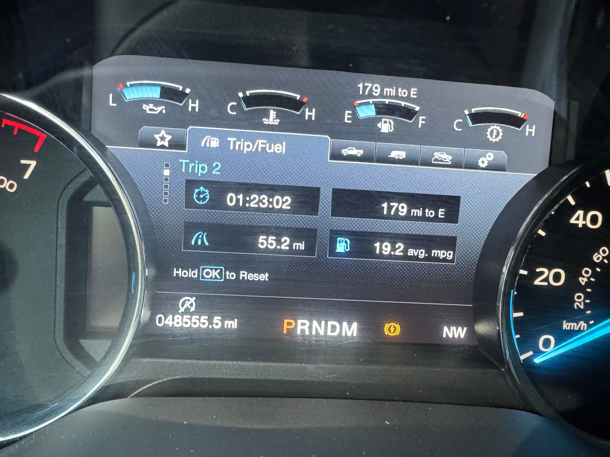

2018 F150 3.5
Anyone know what this dash icon means? Came on when breaking in leaves and abs engaged. Now have a permanent dashboard message “Park Brake limited function”.
No OBD II codes recorded.

That icon is electric parking brake malfunction.
Check fuse #14 in the cab. That's for the brake on/off switch.

Fuse 14 not it, parking brake works. With 14-15 pulled parking brake still functioned and an additional battery icon came up on dash. Replacing the fuse, starting the engine removed the battery icon.
