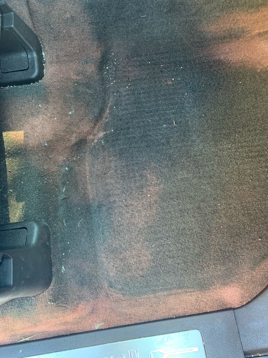

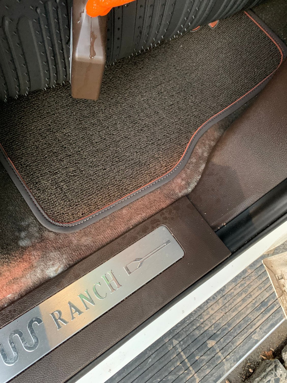

I purchased a new King Ranch last July 2020. Last 5 or so months, I have noticed mold on the passenger side of the car and then realized it was all over front and back, water running through from the back to the front, front passenger floor wet and moldy. I kept cleaning it, not knowing it was part of a larger problem. In the last year, I have taken it for normal service to Ford (oil/tire rotation) 3 times but no body told me about the TSB's or defects i don't know why ford plays these games. There was Mold all over the floor of the car, dealer said front vents, pipes from AC and also the rear of the cab are all defective in the F150, it impacts at least the King Ranch 4 door. Worst part is driving this entire time with family and kids in the car. Doing some more research it seems like it impacts ALL F150s. It took them 30+ days to take apart the cab and get new vents or replacements for their defective engineering front and back, the mold is still on the floor of the car as it's impacted it from the start. It's sad Ford does this to its loyal customers.
Attaching some pictures that show the black mold that had formed, it was all over. It's a health hazard if you have this problem, the base of the car which is under the carpet won't lose mold that easy, sticking carpet over it is just not going to solve the problem.

That's gross!
I could only imagine the mold spores... I'd have them replace the carpet then use a commercial ionizer for a few hours in that truck to burn off the bacteria and growth.
