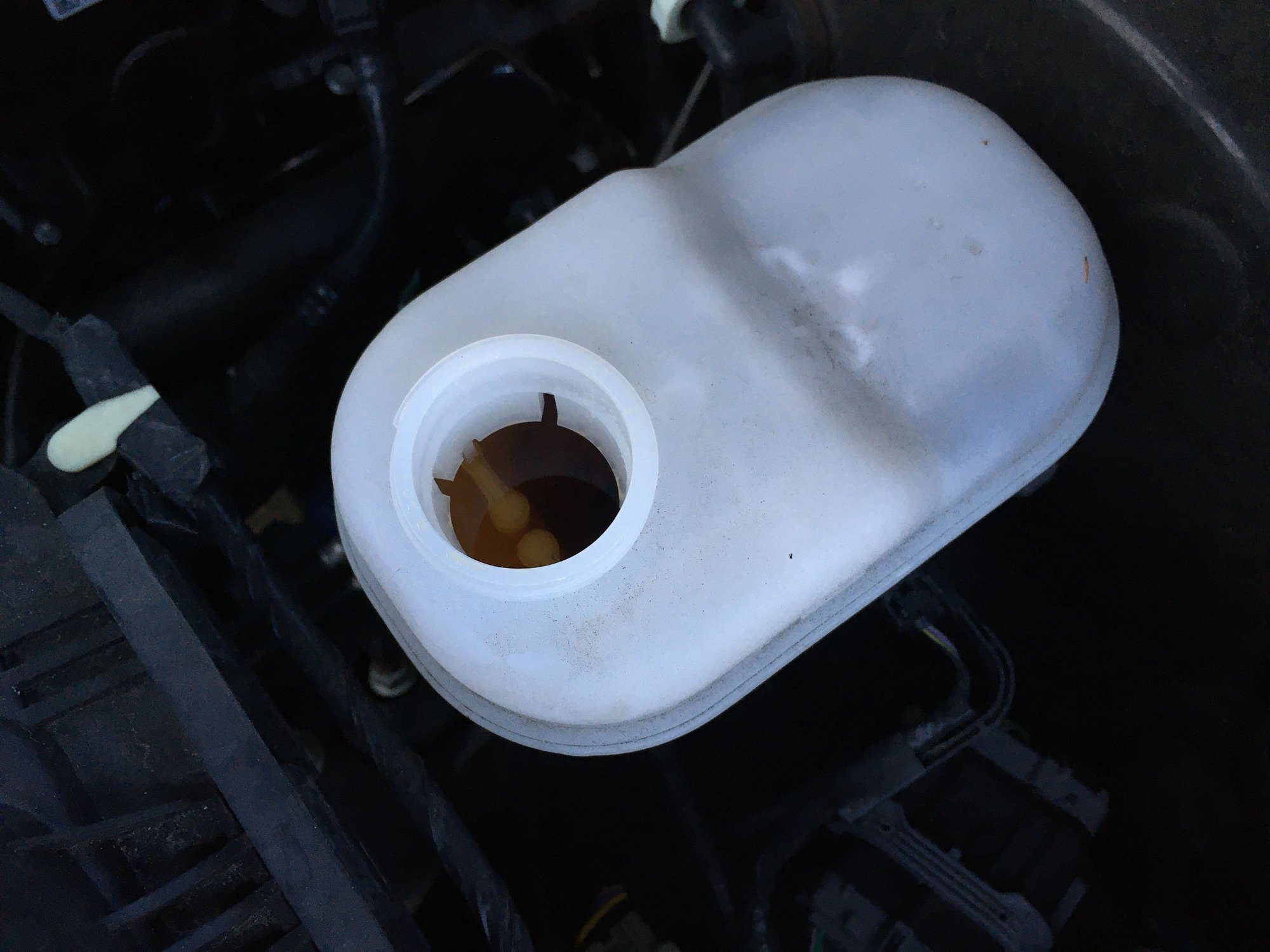

I have a 2017 F150 XLT that I bought new in October 2017. Recently the brake pedal has been slowly creeping toward the floor as I sit at a stoplight. It's not fast I have to sit at a light for several minutes. When I release the pedal and reapply it always comes back and does so quickly. I've had a master cylinder go bad on previous vehicles with the same symptoms but never at 36800 miles.
I've checked the reservoir and it is full. There are no leaks detected by a visual inspection anywhere. Brake fluid tends to make a noticeable mess. I have no check engine lights or fault codes. However, the brake fluid is not clear and looks like it might be contaminated.
I'm guessing I have an internal seal that has failed and I'm getting some sort of blow-by.
Has anyone experienced a master cylinder fail at such low mileage before and might there be something else causing the problem that I'm not aware of?
Fluid level at Max Line
Brake fluid looks contaminated

I suppose it could be a faulty power booster. However, a master cylinder is a lot less expensive.

Probably a bad master cylinder. But first, I would suck out the old fluid from the mc, refill it and do a brake line bleed and fill until all the fluid was fresh if it were me. the lines will need flushing if you installed a new MC anyway. And if you do it yourself, make sure you do a bench bleed on the mc before installing it.
