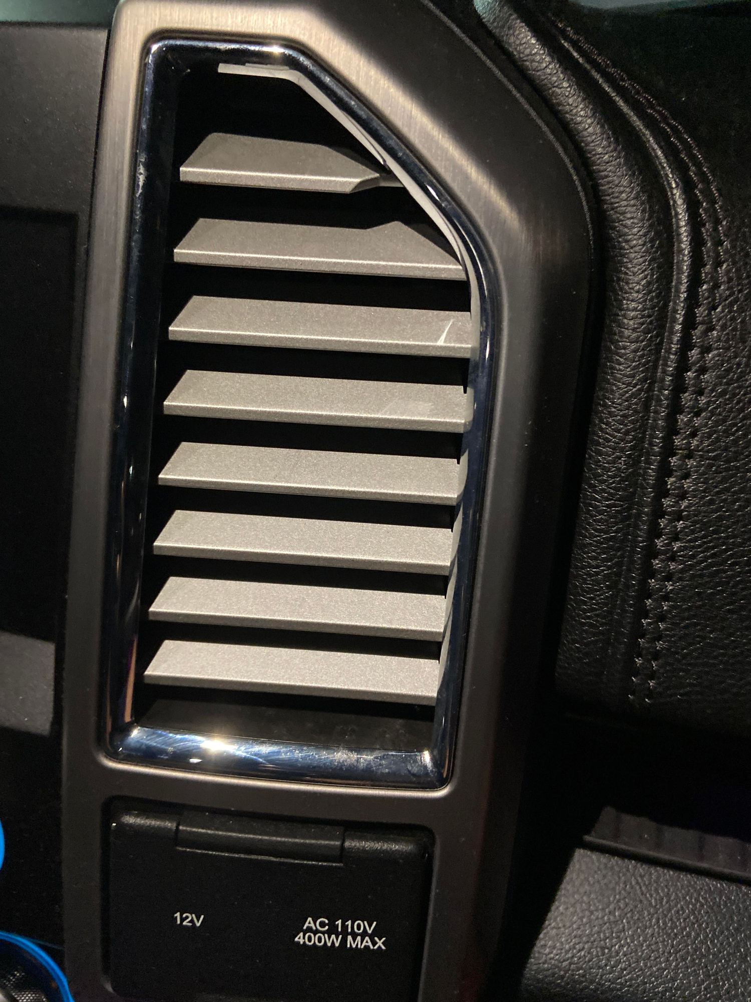

On my truck the part where you use to guide the air broke not the whole airvent(pic attached). The left on the passenger side. How should I go about this? Order a new one ? If so how do I put it in? I have left a link for what I am looking into buying so, but if anyone has a video or something to help fix my problem please attach or any advice about how to go about this. And here is a link to what I most likley buy if there is no other solution to fix it on my own. If anyone would like to say if its correct color wise and overall
the part where it guides the air
Old May 25, 2020 | 08:38 AM
They simply pop out. They are just clipped in.

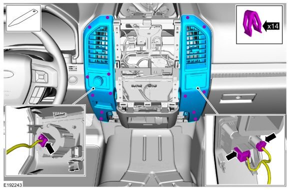

First remove the bezel:
Then pop out the air vent, and pop the new on in. Once you get the bezel out, you'll see how the vent pops out.
This is a 10-15 minute process and it's really easy. Just take your time...
