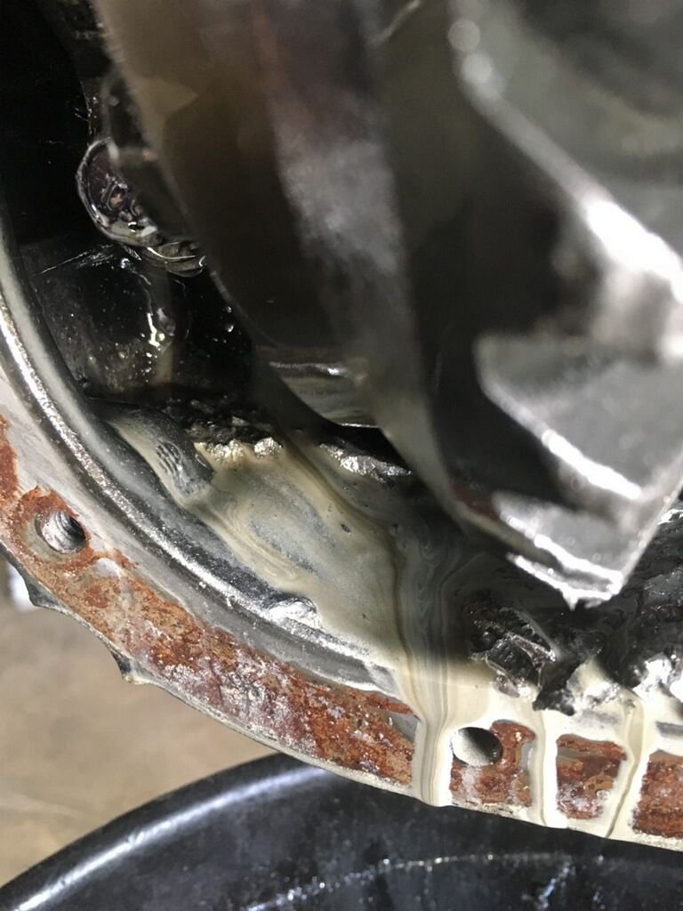

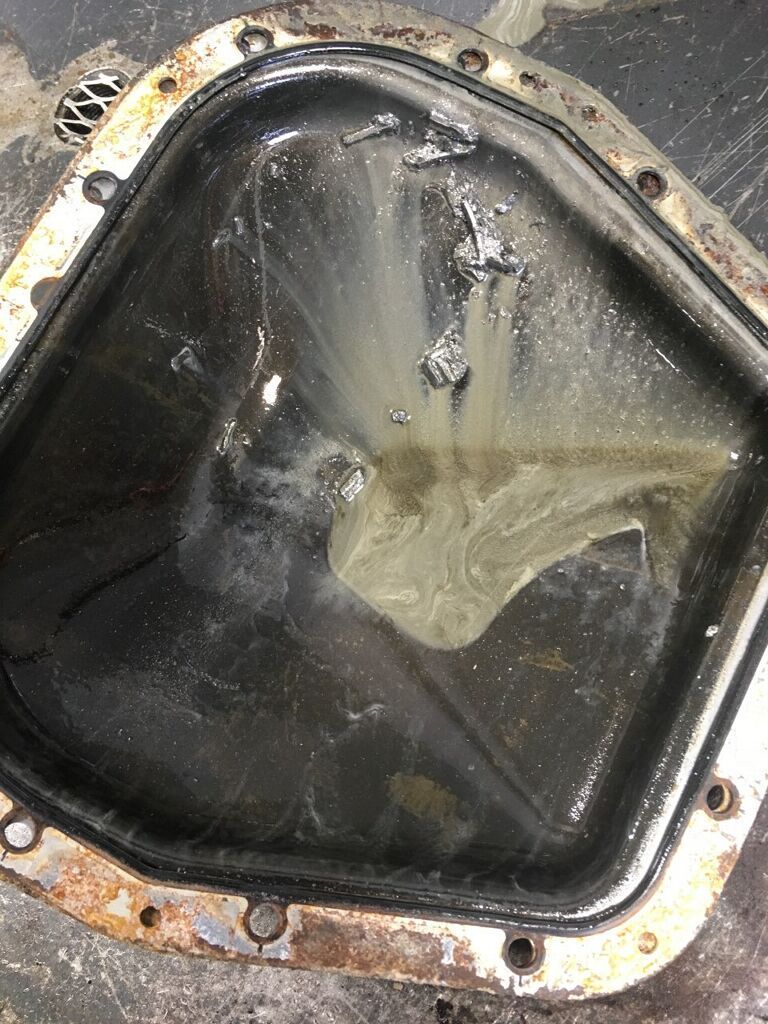

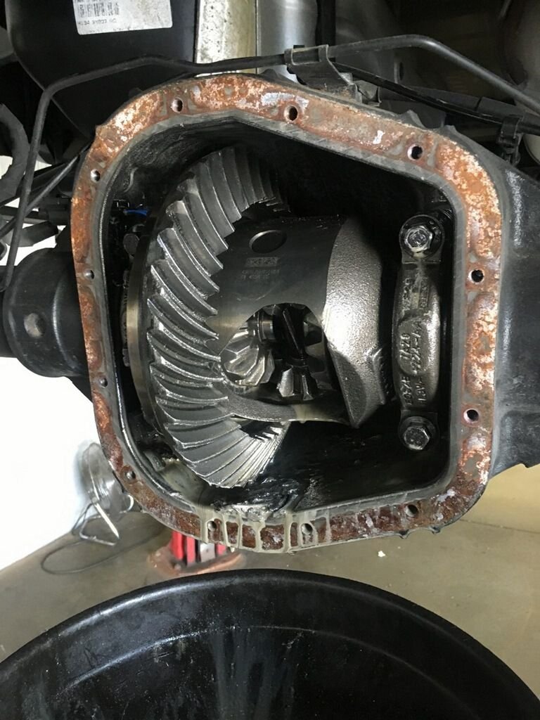

Got a call from dealership, all ford said is looks like water got into it. Here is pics service manager sent me.
It doesn't look like there was much of a seal around the pumpkin, he is also looking at the vent tube to see if it is positioned in a way it could possibly catch water.

I don't think the gasket surfaces should be rusting like that. Water may have gotten past the gasket? I think Ford uses silicone for gasket material on these and in my opinion, it's a bad idea. Looks like they forgot to use the silicone at all. Just rambling.
If you look at the cover there isn't much of a seal on it. seal likely that is how the water may have gotten in. Seems like a lack of seal and any type of RTV from factory may had led to the demise of that rear end.
As much as they charge for these trucks, they need to invest in a little better parts and attention to detail.
