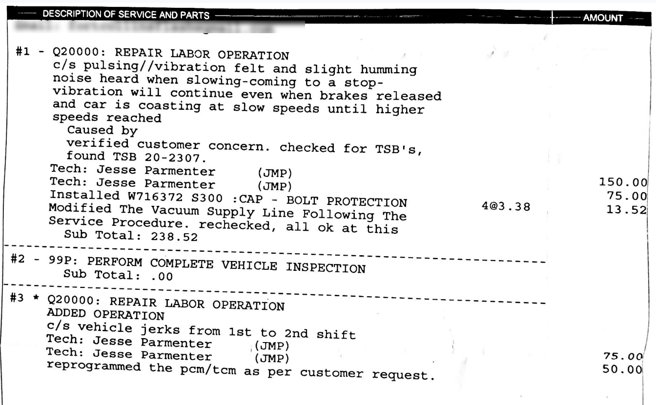

The verdict is in and it is just as I expected. The vibration when slowing is indeed related to the IWE system, specifically the hoses. The dealership installed "modified hoses"; they now have clamps. Vibration is gone.
Of course I could have done this myself, just put on some clamp for about three bucks worth of Ace Hardware, could have saved me a bundle ;-)
Here is the downlow: https://static.nhtsa.gov/odi/tsbs/20...64426-0001.pdf

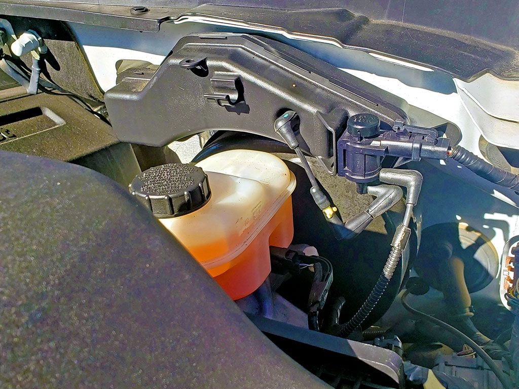

Somebody asked for a photo of the repair done by my Ford dealership. I don't see any changes on the wheel end, but under the hood there is this:

Flash Buddy, thanks for the picture! i see they removed the vacuum source line. I take it they also capped where the vacuum supply was coming from. I tried just using zip ties, and that didn't work. Looks like they followed the exact instructions on the TSB.
An interesting aside; very occasionally I get that special vibration - less than 1% of the time.
what they did is bypassed the vacuum actuator by capping off the lines so the iwes are constantly engaged which i think is a bs repair for them to do, now the front drive shafts are always engaged which could diminish gas mileage that's the only thing keeping me from doing that tsb on my truck
