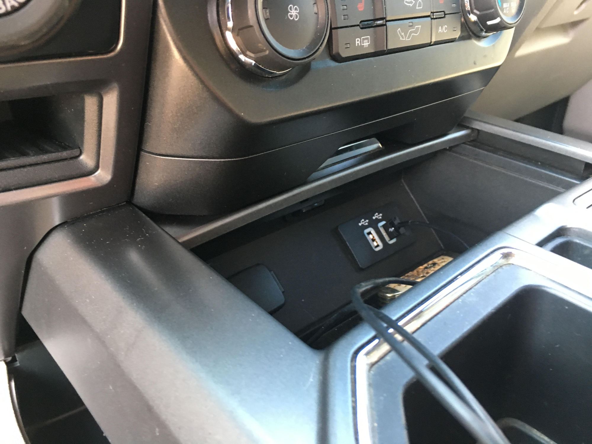

Old Jul 21, 2017 | 09:21 AM
auburn14's Avatar
Joined: Jul 2017
Bottom Piece part number
Bamma07 I appreciate your instructions they were very helpful. I did the sway this past weekend. I wanted to add that I found the part number for the bottom piece that you fabricated. It was $29 from my local dealership. It uses the same screws as the sync trey. Attached are some pictures.
