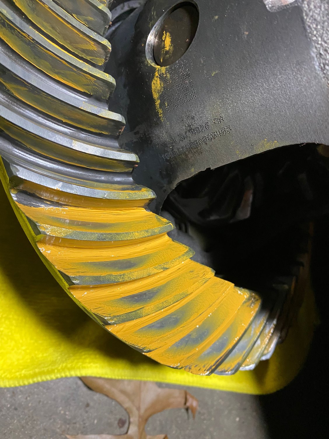

Old Dec 14, 2022 | 09:39 PM
benjamus's Avatar
Joined: Nov 2022
Posts: 9
Is this an acceptable pattern? My backlash is at 11 thousandths, spec says 8-12. I have 20in lb of rotational force on the pinion nut. Think im good to go??
Old Dec 19, 2022 | 08:01 AM
Shawn Cope's Avatar
Joined: Apr 2012
Posts: 7
From: IL
Looks good to me!
