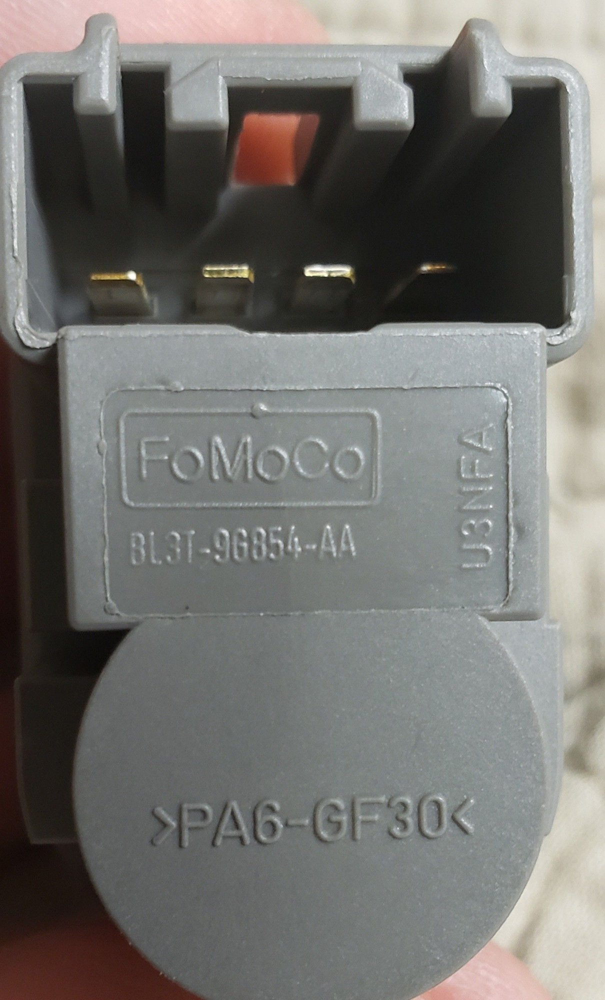

My brake pedal switch failed on my truck (2012 F-150 STX w/ 5.0L)
I tried searching with all the part numbers listed on the switch. Advance Auto has an aftermarket switch however, I prefer an OEM part. Did Ford change or update this part number? Here is a picture of my switch. If anyone knows the proper Ford Part # it would be greatly appreciated.

Is this it?
https://www.rockauto.com/en/moreinfo...015601&jsn=471

It looks quite similar. Thank you. I'll try that part number.

None of the numbers on the part are part numbers. They're "engineering numbers". Ford Parts departments can cross them to a service part number.

Just order that switch from Rock Auto - that's what they show for a 2012 F150 brake light switch and it's an OEM part. $38.79 plus shipping.
