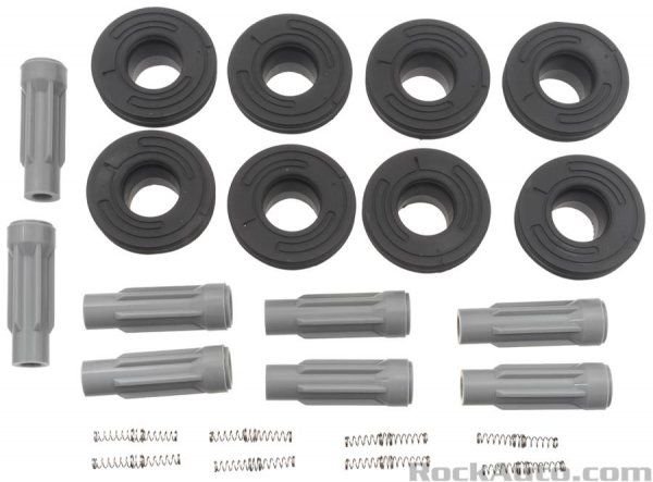

If you are using Motorcraft plugs, do not use antiseize and torque them to 12 ft/lb. Definitely use dielectric in the boots, a small amount avoiding getting it on the contact springs. Be careful not to break the coil connector clips.
I would consider replacing the coil springs and boots.

Thanks for that tip.. do these normally need replacing with spark plug changes? How do you tell if they need to be changed?
Are they pretty easy to replace?
