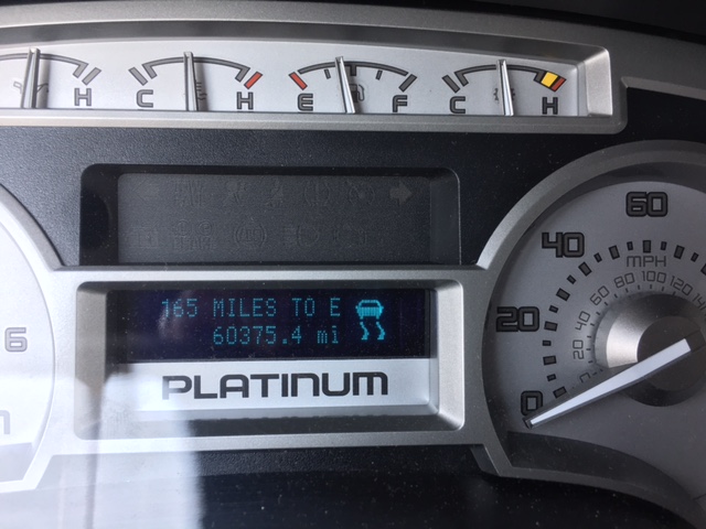

I have a 2010 F150 Platinum. I had the Ac worked on this past week and they had to remove the dash to replace a actuator door I think it was. Now the Stability Control light stays on all the time. When im driving there is a little play in the steering wheel and I can feel the Stability Control I think trying to control the truck. Would removing the dash possibly have anything to do with this problem, which was not there before I had the Ac worked on? Is there a way to just disable this all together? Someone said hold down the Stability Control button for 10 seconds, I did that and all it did was start blinking then go solid again. The place I had the Ac worked on is closed until Tuesday so I cant call them until then. Any help would be greatly appreciated.

that probably does not mean that stability control is on.
... that means that stability control is faulted
I'd take it to a dealer to get the codes read.
Might be coincidence (maybe a bad Wheel Speed Sensor)
or could be more expensive.
The only thing under the dash (other than power wires) that they could damage is your acceleration sensor. If they broke it then I would expect it to be an expensive fix. This could also disable your airbags if it is broken.
