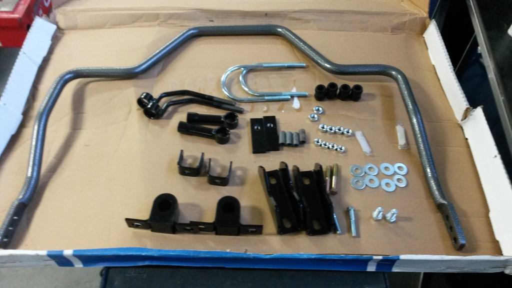

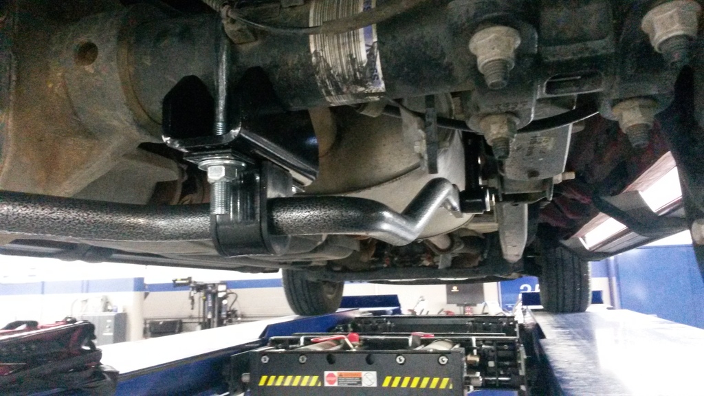

Install is very easy. Took me about 30 minutes even with taking my time reading the instructions. I spent about another 30minutes after install to "tune it" or "adjustment"

Per the instructions the recommend you install it on the weakest setting until you get used to how the truck handles with the added antisway bar. I started with the middle hole (middle strength) and havent moved up to maximum setting. Im pretty happy with midgrade. I think Max might be too much with the stock sway bar still up front. Back end might get too tight and want to start being somewhat dominate, and less compliant.....

There is a threaded plate you slide into the shock cross member, to utilize an existing hole in the crossmember, you attach the upper clevis to that plate, them the top of the endlink.
Upper endlink has male threads, lower endlink had female threads, it adjusts like a sleeve tie rod type adjustment. End link changes length to level the bar.
And then you have rotational alignment on the axle via the Ubolt clamps under the axle
No drilling, true bolt on install. Very simple and intuitive

I installed a second one on a friends truck last weekend after he got the replacement parts he was missing. I did in in the street with his truck parked up against a curb, in about 45 minutes.
As for the end link adjustment, you just need to take the lower bolt off the bar and thread it up onto the top part. The ideal sway bar configuration is with the sway bar parallel to the ground. It obviously doesn't have to be exact, but it performs best when level.
For both stock 2wd trucks the end links ended up about 3/4 of the threads in the sleeve

That's where I put mine to start with and yeah, it's dead level. I'm not sure I understand why they want you to assemble it using the end hole in the bar though. I just put it in the middle hole and put it together. What tool did you use to tighten the jamb nut on the links? I'll probably go buy a crows foot this weekend as I can't get a conventional wrench of any kind on mine. A crows foot on a ratchet would work though. Mine is snug tight but not tight, not that it's going anywhere.
Old May 26, 2016 | 09:27 PM
it won't really fall apart with the Jam nut loose, but it would eventually destroy the threads on either the sleeve or the rod.
I used a basic wrench 22mm (I think) over the leaf springs, slightly downward angle to the wrench
