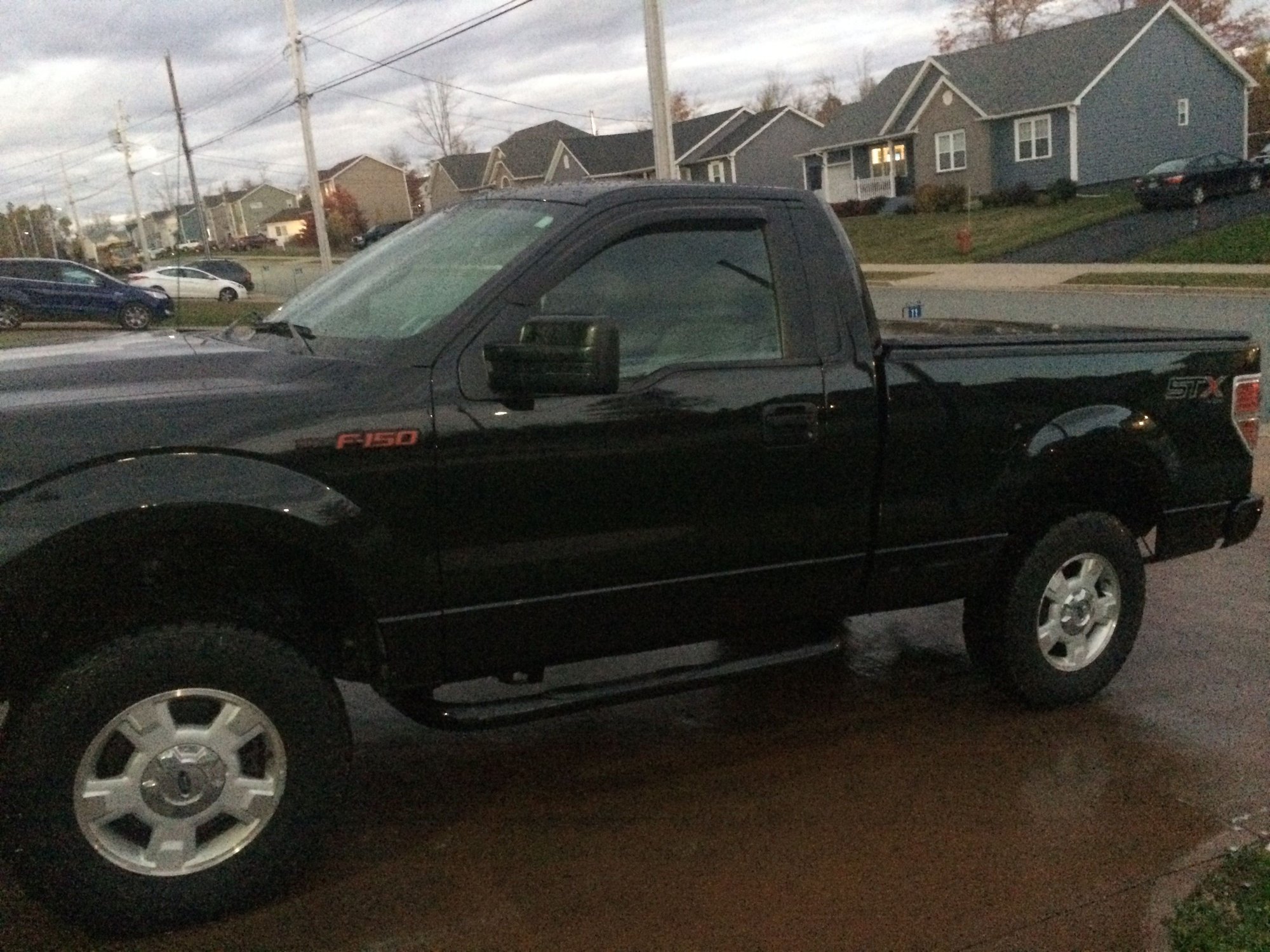

So my truck is. 3.7L 4x4 Regular cab with a 2" ReadyLift leveling kit in the front. Most importantly I want to say my truck is a daily driver. It's not my toy not do I have the money to start replacing or upgrading front end parts. Moral of the story I want bigger tires but I don't want to go overboard and make my truck unreliable.

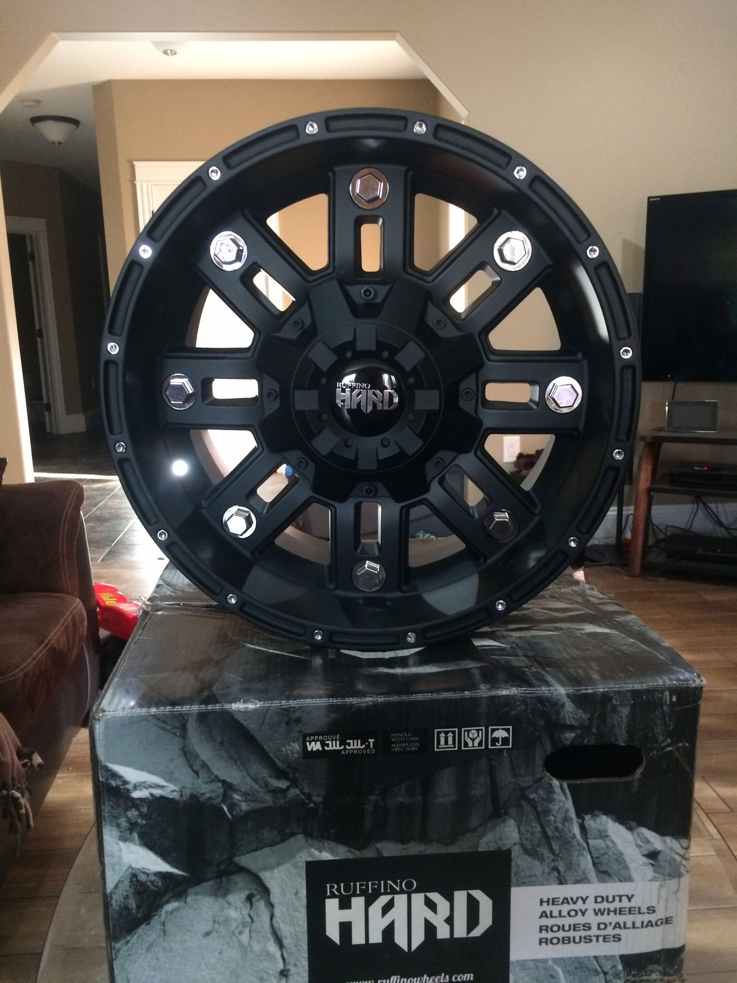

So I bought new rims 17x9 with a 15mm offset
I'm set on my tire brand. Goodyear Duratrac. However before I pull the trigger I'm trying to decide on 285/70r17(33x11.5) or 315/70r17 (34x12.5)
So my questions are:
-do you all think the 34x12.5 are to big for my needs? Will they prematurely wear out my truck?
-Will a 34x12.5 fit without ANY trimming at full lock with my 2" ReadyLift leveling kit?
-do you think a 34x12.5 would look stupid on a 17" rim?

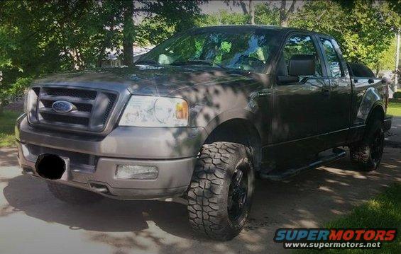

How about a 295x70x17 (33.5x12) I had them on my '04 Lariat with 17x9 wheels with a 0 offset and they fit and looked perfect. I ran 315x70x17 BFG's on the same wheels earlier and they rubbed in the front even after some trimming.
Here's what the 295x70x17's looked like.
295x70x17 Toyo MT's on AmRacing 17x9 Crater's

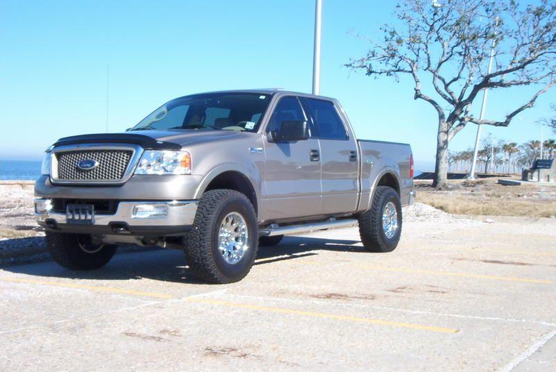

I think with your engine and rear end the 285x70x17 Duratrac is a good choice. Kind of a hybrid AT and MT tire. Here's some pictures of the 315x70x17 BFG TA/KO's on my '04 with the same 17x9 wheels...this pictures were taken over 10 yrs ago.
315x70x17 BFG AT's on 17x9 wheels that rubbed.
