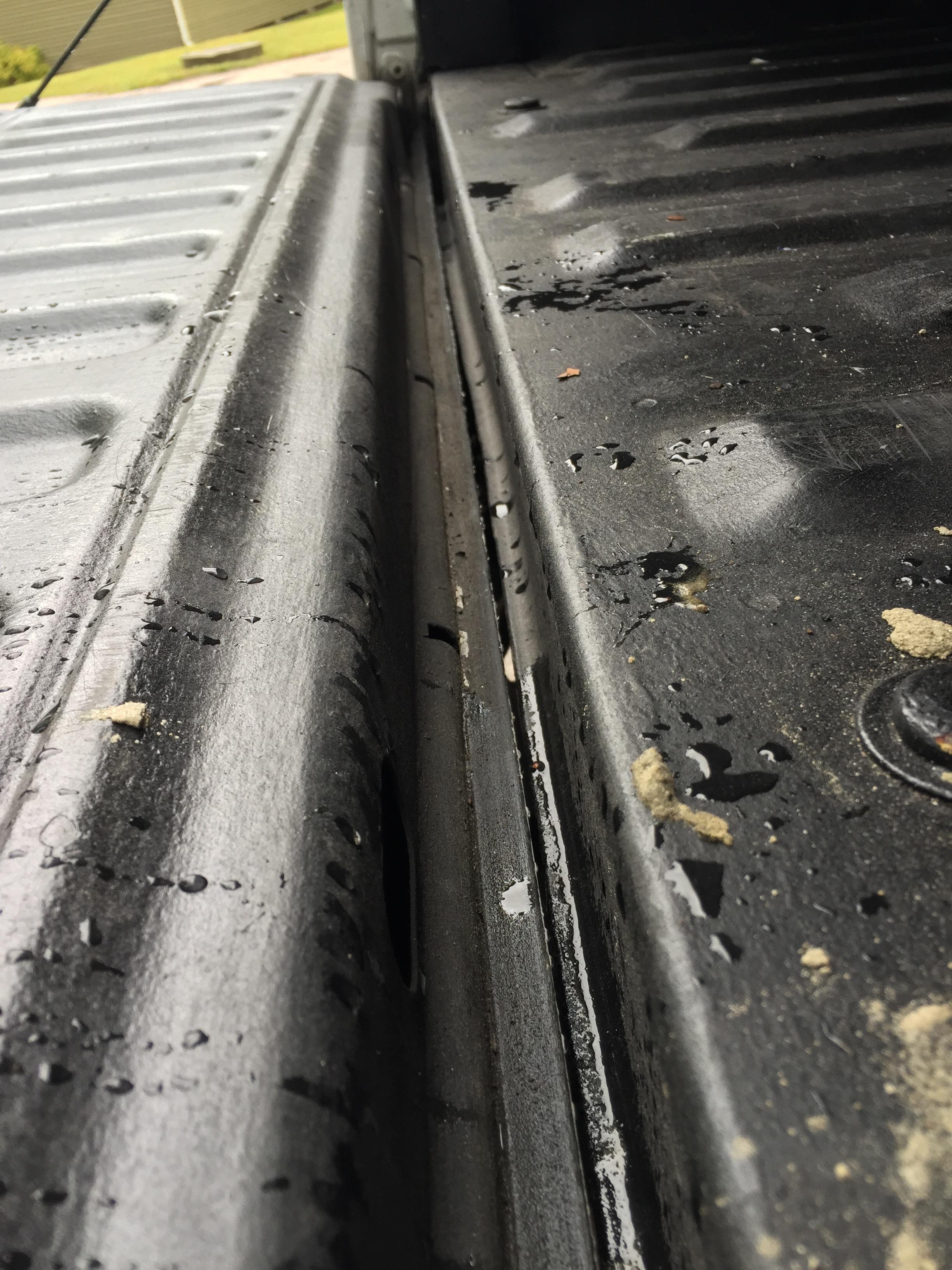

So I bought my 2010 FX4 a year ago and after a few months of owning it I noticed that the third brake light had the common leak. Took care of that issue but I was under the truck yesterday cleaning it and noticed that the cab corner on the passenger side has bubbling paint and it's obviously starting to rust under it. From reading it sounds like Ford will only warranty it if it's rusted through which it isn't yet. Im closing in on the end of the 5yr rust warranty and was wondering if anyone was successful in getting Ford to fix it without it being completely rusted through?

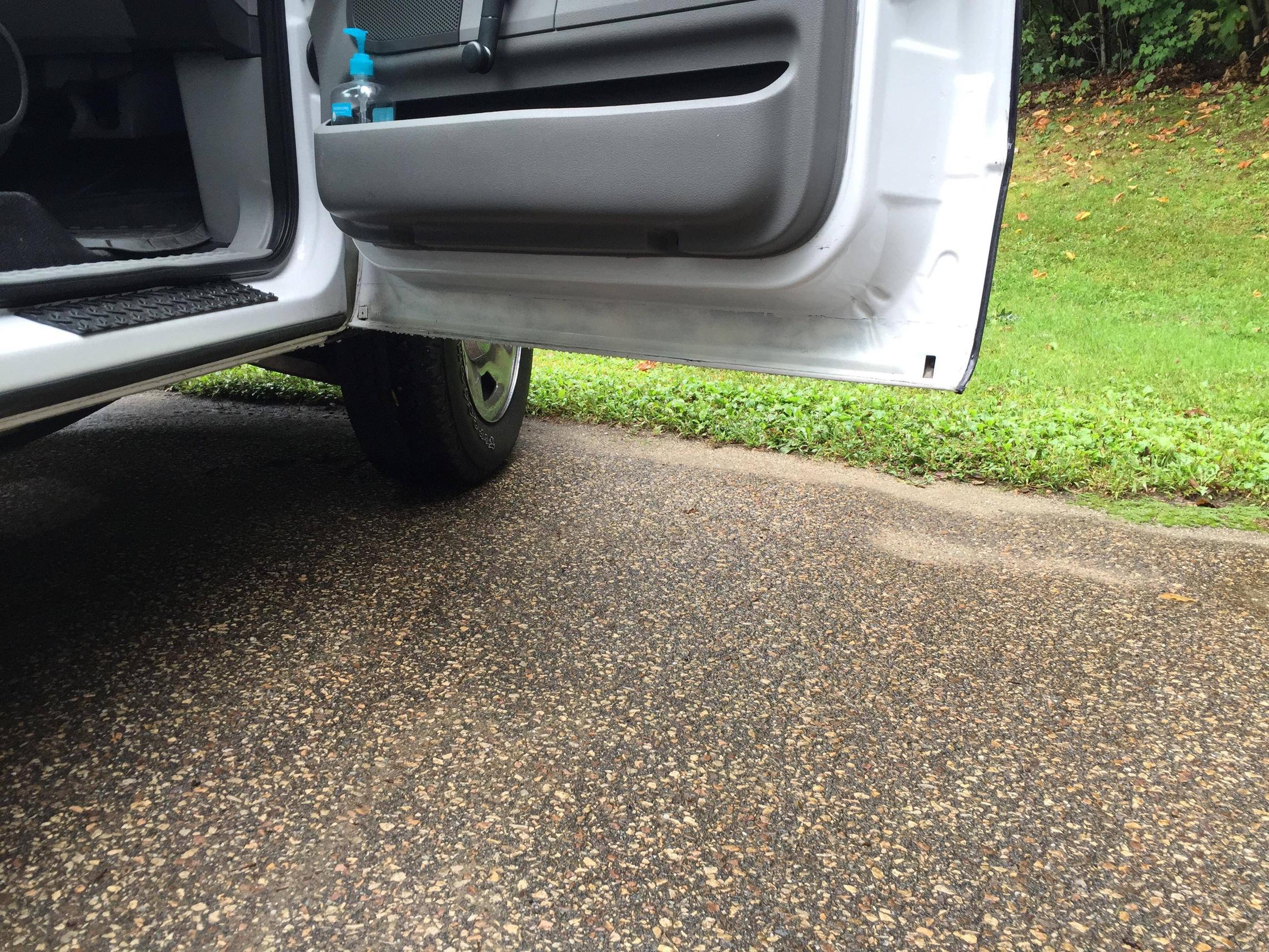

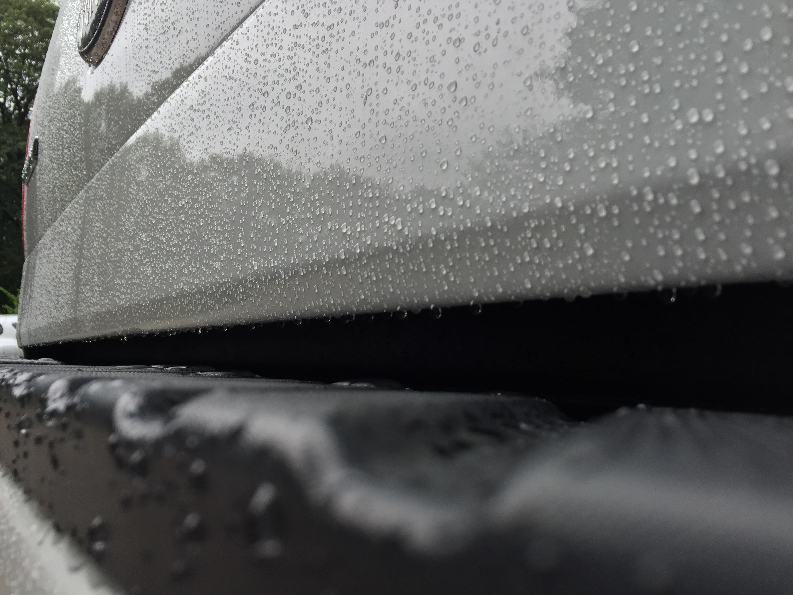

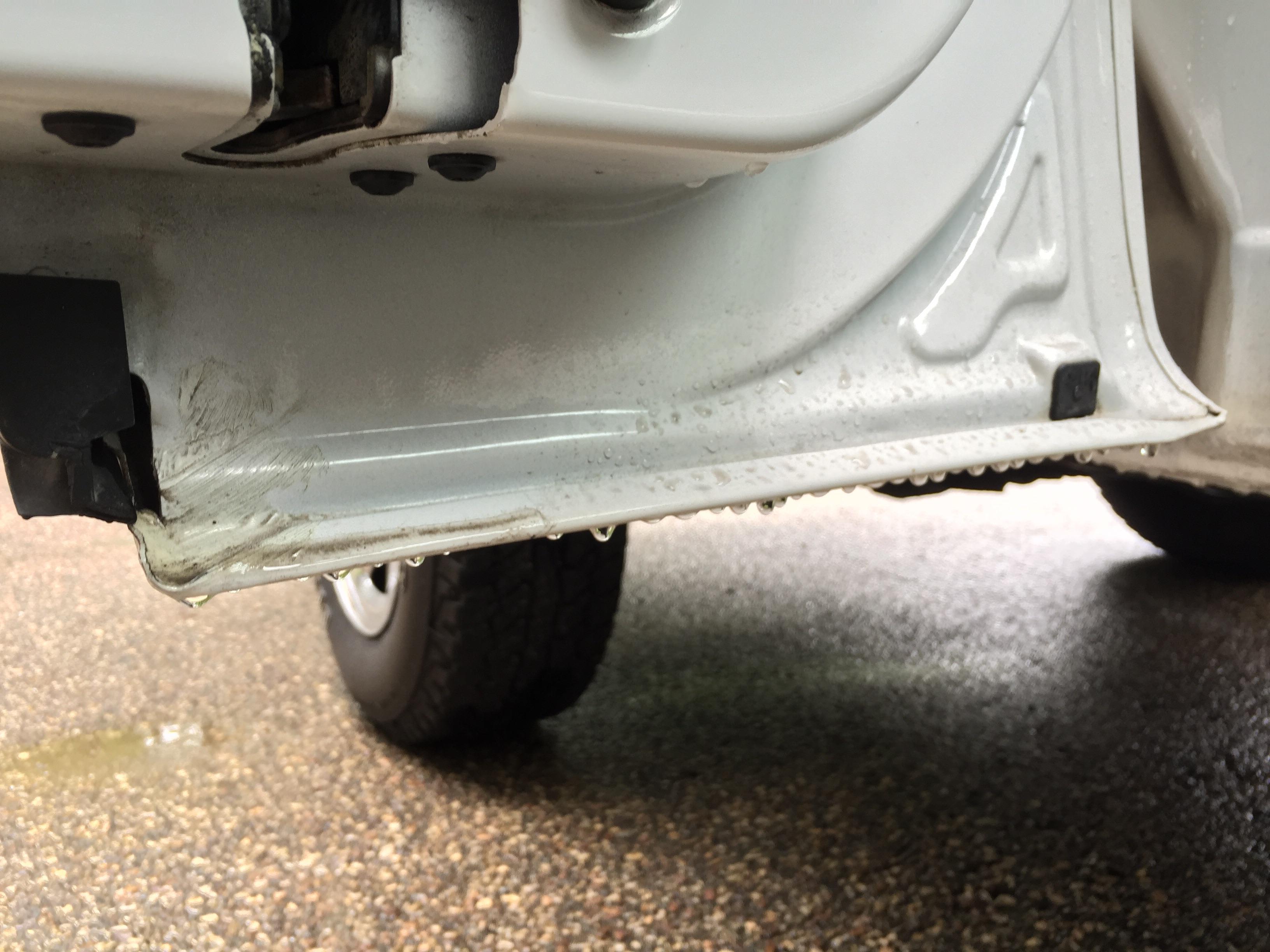

While you're at it check the bottom of your doors and tailgate. I'm confident you will find some there too.
I love Ford trucks with the exception of the corrosion protection. I have yet see a daily driver in salt state's that make it my past 2 years without paint bubbling at the exposed edge at the bottom of doors and tailgates.

Actually, I treat all those edges with white lithium grease before winter. I spray them all with a high pressure hose weekly during the winter months too.

Just as a suggestion, make sure that the drain holes in the bottom of the doors and body are open and draining well. Dirt, leaves ect will clog them up and trap water inside the bottom edges and that will rapidly rust them out.

From reading about it and others complaining of the same issue I'm certain its related to the third brake light leak that is so common on these truck. I've taken care of that issue but who knows how long the truck has had water pooling up in the cab corners. I've looked the rest of the truck over and that is the only sign of rust anywhere on it. I do have a car fax on it and the truck was delivered to a dealership here in NC when it was new and it has always been registered in NC and I am the second owner.
