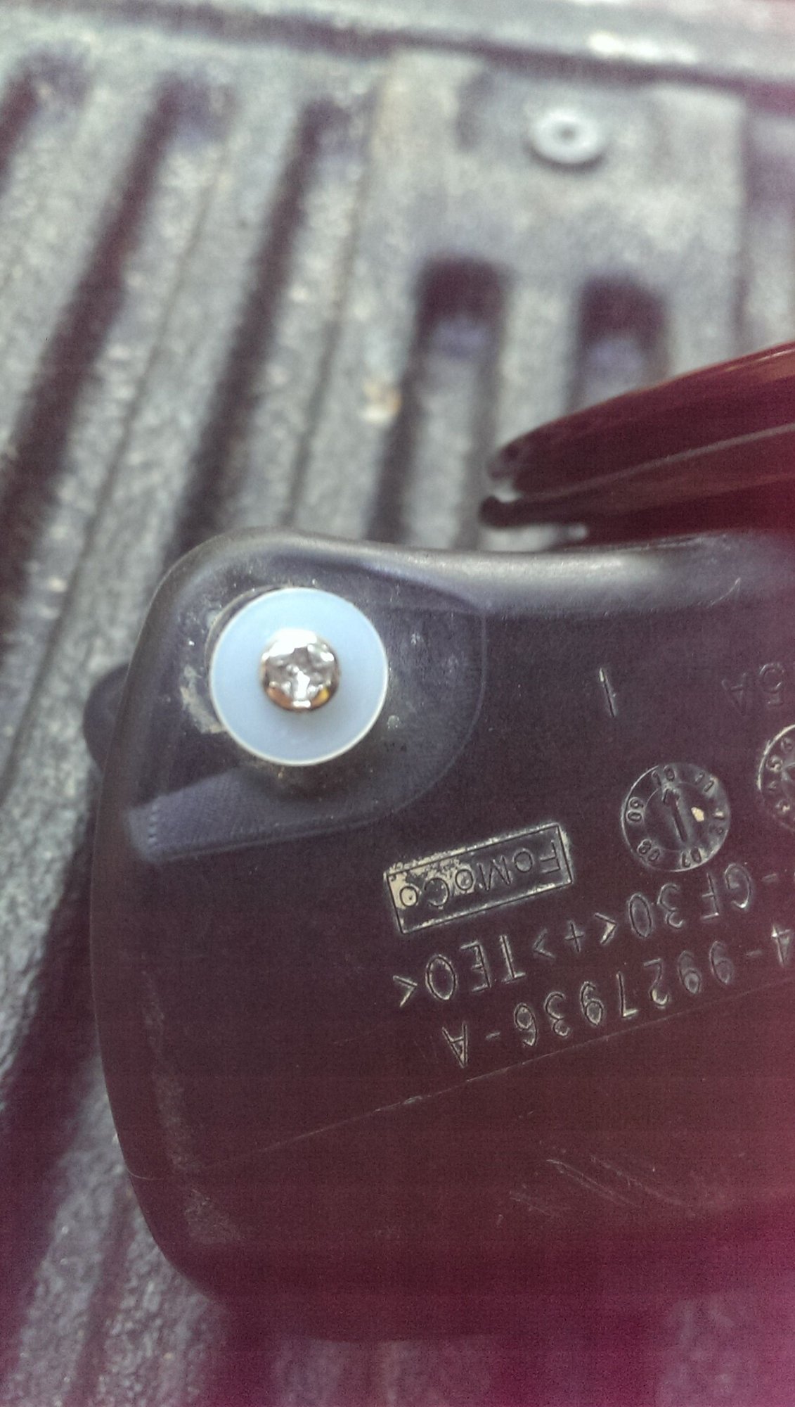

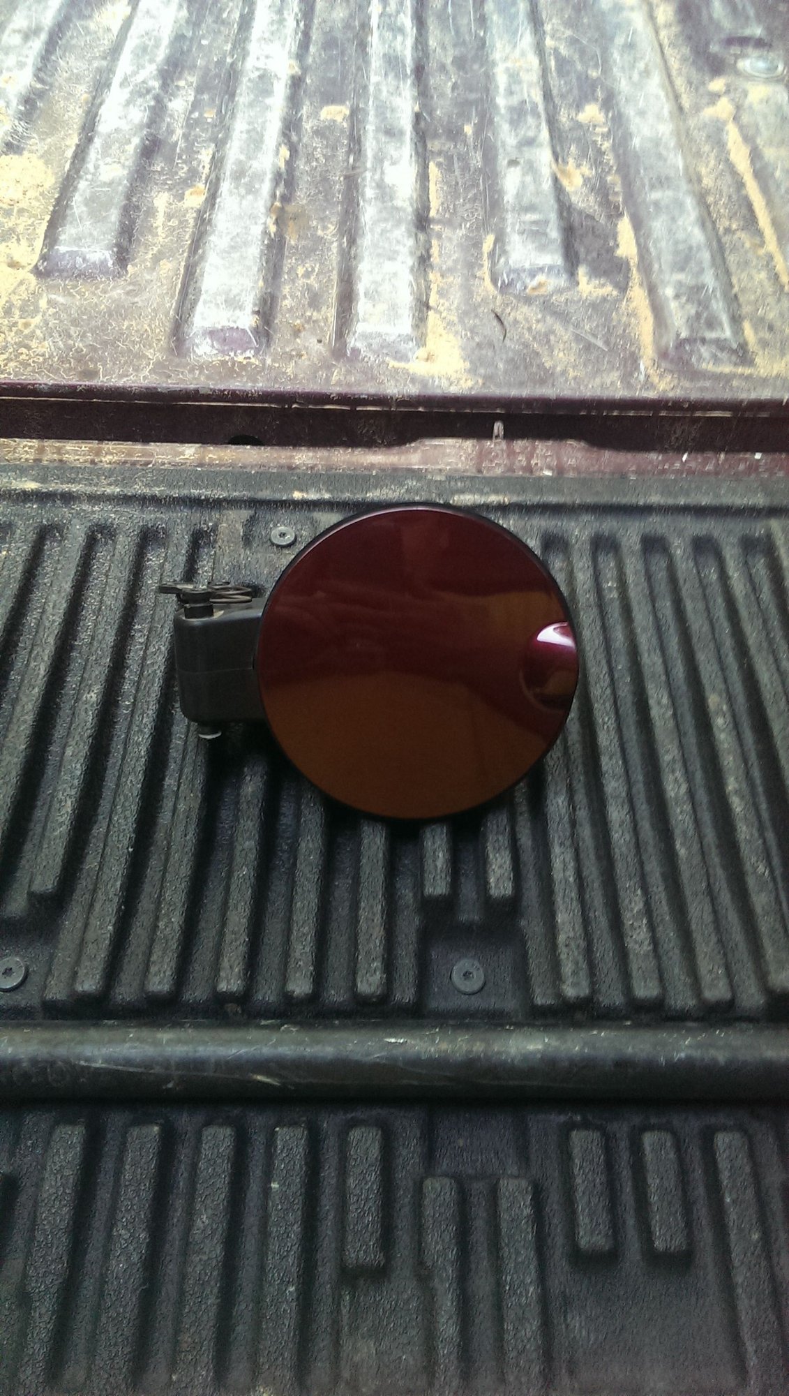

When I bought the truck the fuel door was loose and didn't snap shut, it wasn't a big deal until about 1 week ago it started popping open when I was driving. I was extremely annoyed so after some research I found out it's a pretty common problem and its also an easy fix, so I fixed it
Glad I didn't scratch it up
Drilled a hole into the bottom and put a washer on it so it shouldn't pop up again
